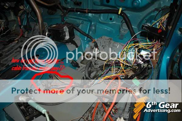

ok teal so im about to restart working on my wire tuck so i can drive my beloved car again! lol! anyhows i got 2 questions and included piucs so if i could just get these answered ill be good to go ha
ight first i need to know if you extended the wires going to the engine harness in this pic
next iu need to know if there is a trick to getting this part of the harness into the engine bay?? im havig the damndest time lol

have to drill a hole for the engine harnness. and for the headlamps u need to remove fenders and you will see a lil black hole plug. pop it off and ther is were you run the wires.

I extended the wires on the top right, you can see all my bright colored wires instead of the black loom from the factory.
That lower right plug you're talking about.. is that the one with the 2 really thick wires? You can extend that too, just be sure you use the proper gauge wire, nothing thinner than what is already there.
The only wires you have to be careful extending are shielded wires. The o2 sensor and dizzy parts of the harness are shielded.
