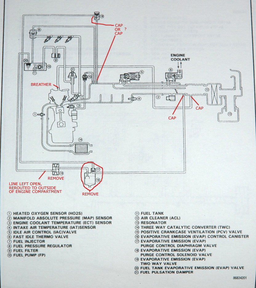

#175266 Do you have a Helms or Chilton's manual? They have diagrams for vacuum lines, electrical sensors etc.
If you have an important sensor unplugged it will throw a CEL. There's a Evap Purge that you don't have to have plugged in on these cars. But your jumping idle is most likely a vacuum leak, so find the open or cracked vac line and fix that first.
here's a vacuum diagram... never mind the red type over it:
I'd say first fix the known problems you have. It's tough to diagnose problems when you have other problems to fix first.

#175286 that diagram is impossible for me to read, i cant tell what is wat by lookin at that man, i need a real picture with arrows labeling which sensors are which, that doesnt even look close to anything i can use
