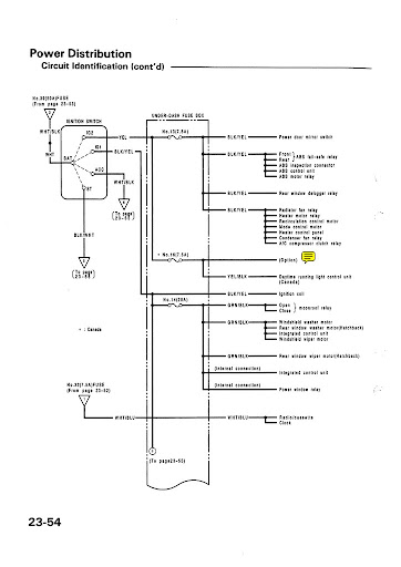

ok so basically here is the wiring diagram and some problems i ran into.
this is pretty straight foward except it just tells you grn/blk goes to fusebox sooooo you'll need this diagram...
tap into the grn/blk wire that runs your rear wiper, rear sprayer etc
now for install...
