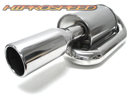

#105488 hey guys i wanted to know if this exhaust more quiet the other ones out there..
By 93cxhb
#105586 :shock: . thats a horsepower robbing piece of metal but from the way it looks it might be quite
By project-eg
#105637 those exhaust are quiet but you will loose power
By suspendedHatch
#105657 Twin loops in general or just that particular brand?
A good twin loop will have mandrel bends and the inside of the muffler will be a straight-thru type. This wont cost you any power. The extra length of the piping moves your power band downward in the RPM's where it is more usable.
