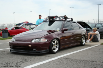

#189557 Hello guys!! anyone here who knows "how" to lift the back of the hood like in the picture below?, because weather here in "PI" is so hot, i just wanted to try it this summer if it works fine ;;I'd be more thankful if you will include pictures on how to do it. Thanks!!!

#189561 i used electrial conduit, (the hard plastic stuff, i think thats the right name for it) and spaced the back of my hood, i dnt remember if the pieces i cut were a 1/2 in or 3/4 in though....

#189604 I used plastic spacers from the hardware store they worked real good. I used the one inch spacer with 1 1/4 inch bolts with washers

#189631 thank you very much for the info guys, quick question, the hood has 2 hinges and each hinge has 4 bolts,2 bolts connecting to the car body and 2 on the hood, where should i place the plastic spacers?
#189633 on the hood, putting them on the body would push the hood out more

#189760 take the hood bolts out and put some washers on them
