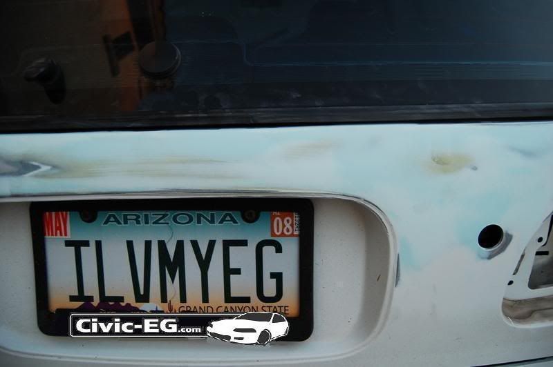

easiest way to me and i really am strongly against this way is to pop of th rear emblem and the back part of the tailgate or trunk....place a peice of tape or something to cover up the holes and smear bondo filler over and sand.....i left out a few steps because its the easy way not the right way.....
right way would either be to weld up the holes, or cut out the metal with the holes in it for a peice of sheet metal to the cut hole weld it in bondo up the seams and make it flush then paint...

no bondo or cracking in the future, but then that also comes with a new paint job also.
