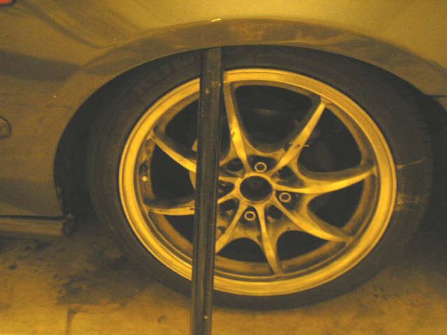

Image I decided to use my jack extended arm. Some may heard using a baseball bat. Well I also did't feel like raising my car up. This worked better because at my ride height, It gave an ideal of the right gap for clearance.

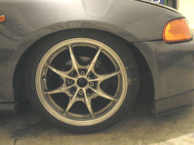

Image My stance.

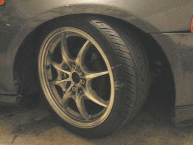

Image I just shoved it right because it starts gripping where it falls between the fender and tire. So start rolling.
Image Rolled if half way then met the mounting points for the inner liner, so I just pry between them and push it toward the fender.
Image It now once done, it flared the fender slightly. No more rubbing!

I would wrap the metal handle in something like a rag so it does not scrape up the paint on the inside of your fender lip and start to rust.
