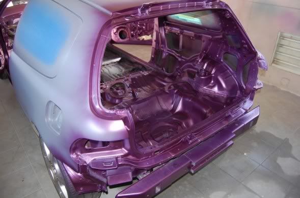

Here is a pic to kinda see his dilemma...
http://i156.photobucket.com/albums/t27/ ... 6hncpj.jpg
red92hatchback wrote:i took the panel off but there is metal behind the part that is damaged. i cant get to the actual metal that is dented. so what can i do? this is really hurting me to see my baby this way
