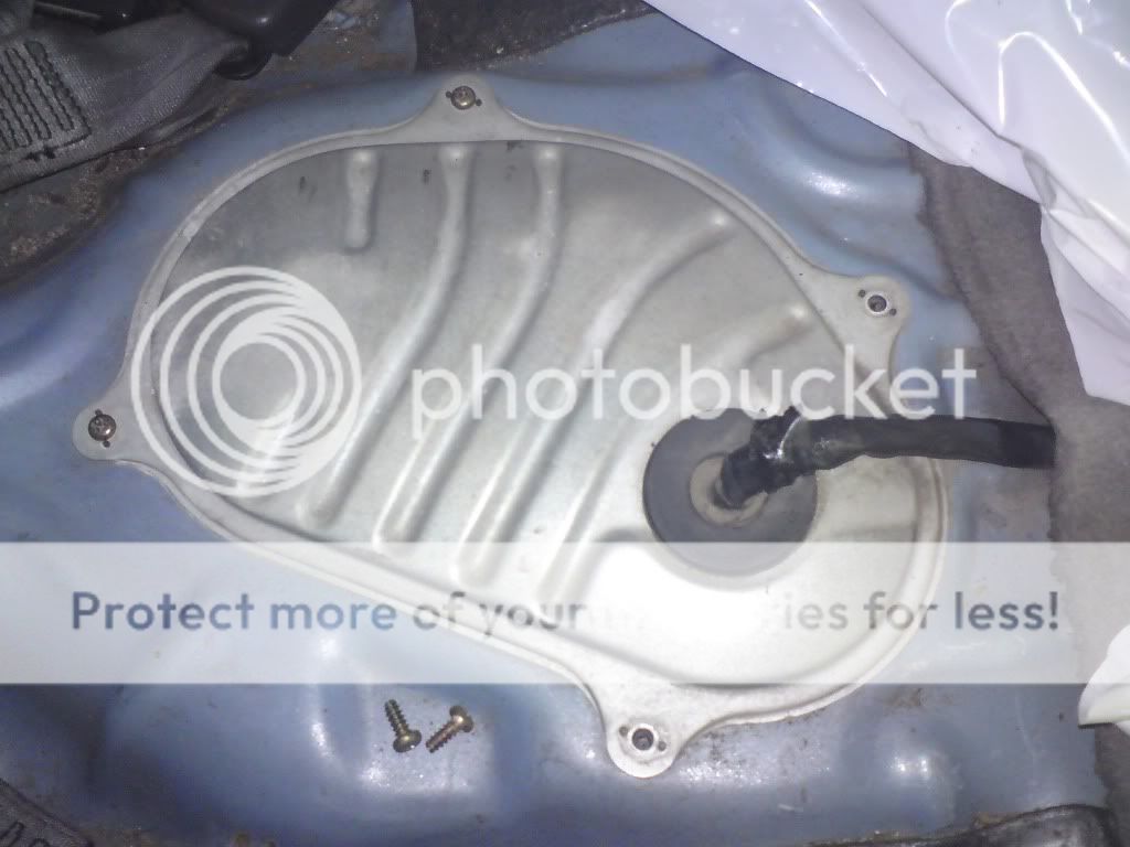

ABOVE- Lift up bottom of rear seat, you will see this cover. Remove four screws with your star screwdriver
ABOVE- sorry pic is slightly mis-rotated (not sure if theres such a word) and can't straighten it, but you will understand. Okay once the cover is off you will see this, see that dust (16 years of it lol) take your paint brush and sweep it slowly towards the front of your car, you will see a hole where the ground is visible, then once most of the dust is gone take your cleaning detergents and spray it and clean with a cloth. Now ...

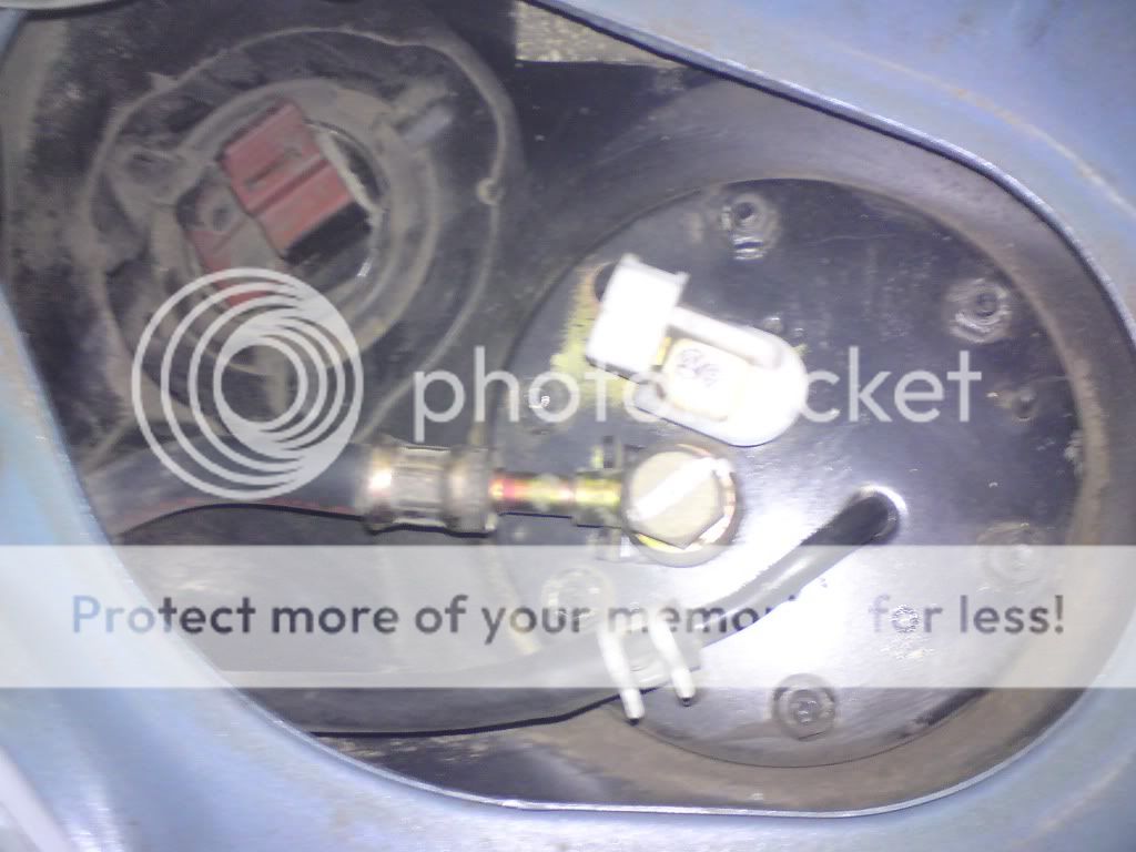

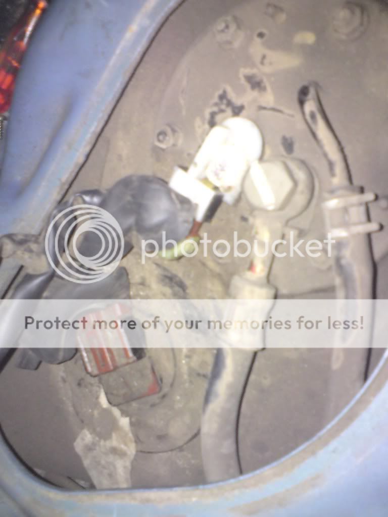

ABOVE- ...it should start to look like this (you can get it more cleaner, i did not take a pic of how clean i got it sorry), see the plugs are unplugged... :thumbup: , then you see three prongs , take your flat and hammer and hit this in an anti clockwise direction and should loosen up- if its tight like mine was then spray some silicon spray
ABOVE- when you done the above you should end up looking like this...

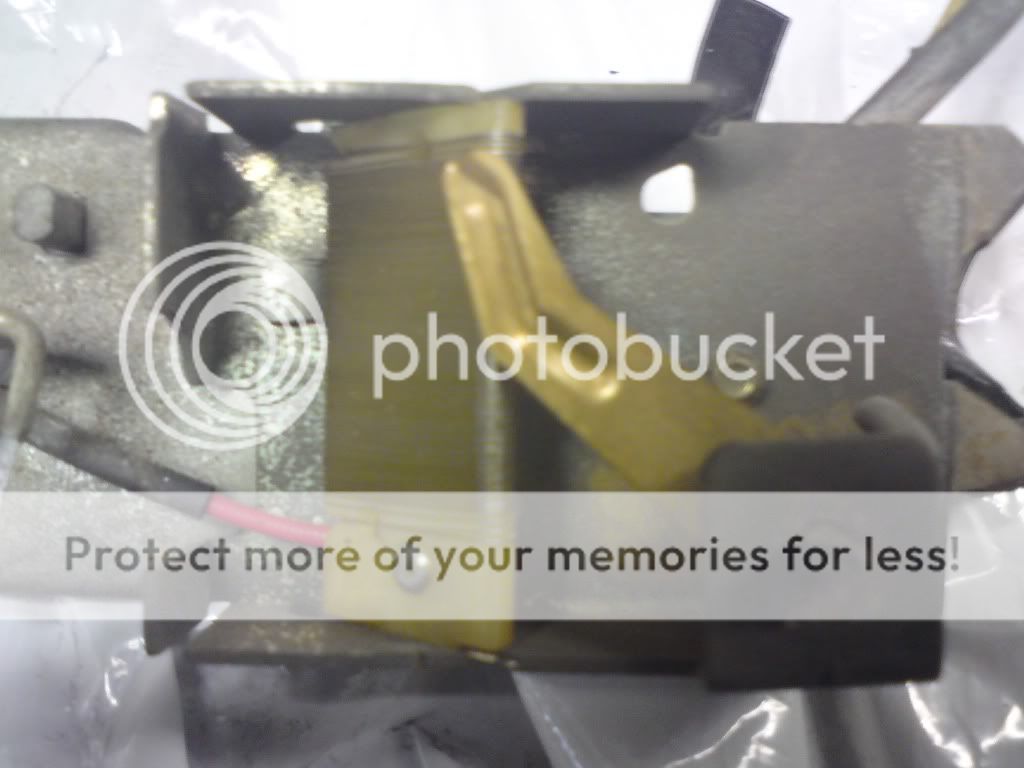

ABOVE- carefully pull out the float, watch out for the big black float as it just makes it out the hole...hey this thing still looks good right??? look at that rectangular box, remember it and go to the next pic

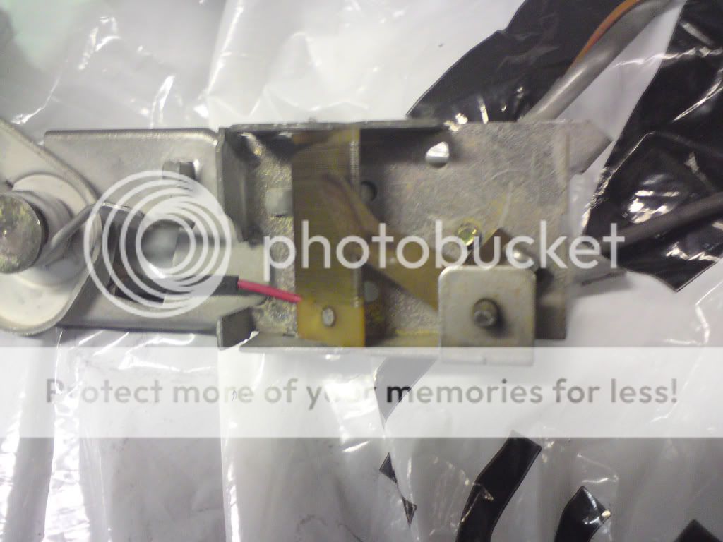

ABOVE- open it using you flat- it has three clips at the bottom of it and once opened- look at those wires- they are burnt, so that tells you when you have reached max or min aswell as kicks the reserve light on...YIPPEEE now we all know whats the cause...
ABOVE- so i took out that electrode whatever its called, out of my second hand one as my one looked better...and lets see what happened

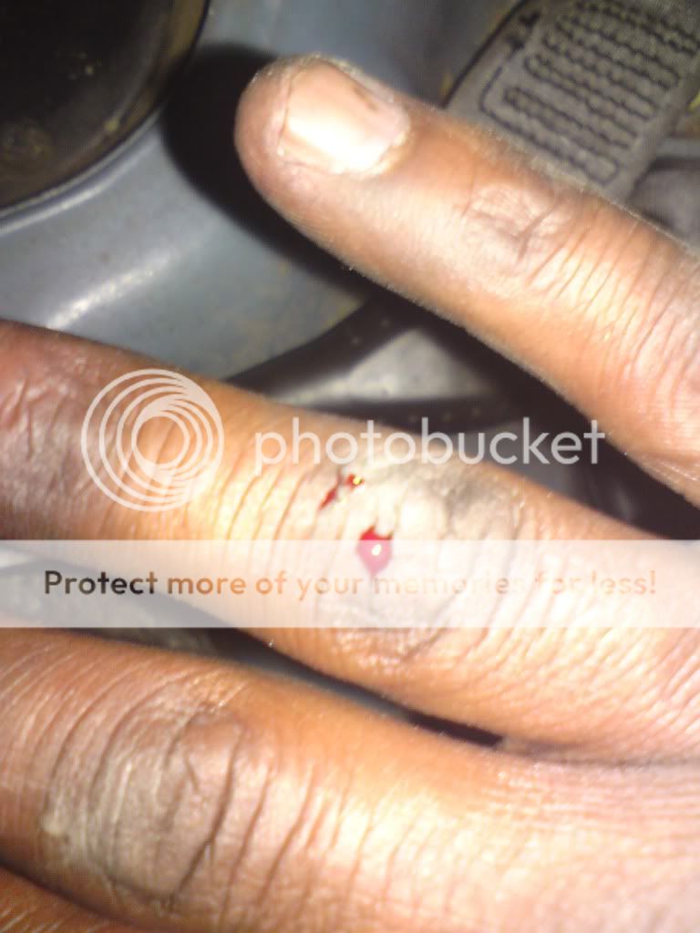

ABOVE- I F#*cking cut my fingers, as the saying goes; "no pain no gain"- so carefully put everything back and clean your sh!t as you put it back. and look what happens...
ABOVE- i hit reserve, now i had to drive my car till my fuel ran out - luckily it was almost empty lol.
