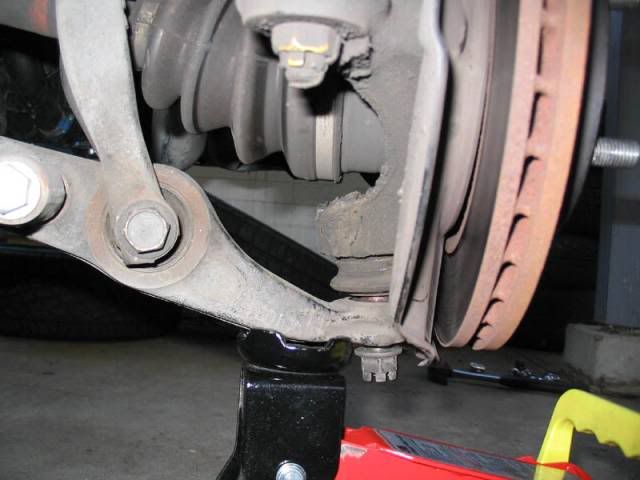

#204746 Put a jack underneath the ball joint on the wishbone, and jack it up until its almost lifting the car off the axle stands, that should give it enough force to grip so you can get it tightened up.

#204748 Like this?
By Xaser
#204750 Yeah and is that fails then you'll need to clean the thread up like a bugger and get some copper ease on it :lol:
Edit: an impact gun is always helpful as well hehe, would need to rotate the jack to the side though to get a gun in.

#204790 hmm, Ive lifted the car and lowered it onto a axle stand as it is in the above picture. The joint turns as freely as before? it turns very easily..... :eh:
By d-mon
#204806
ANDYC wrote:hmm, Ive lifted the car and lowered it onto a axle stand as it is in the above picture. The joint turns as freely as before? it turns very easily..... :eh:
it might be time to replace them.
they are 'pressed in' and should not turn at all.
