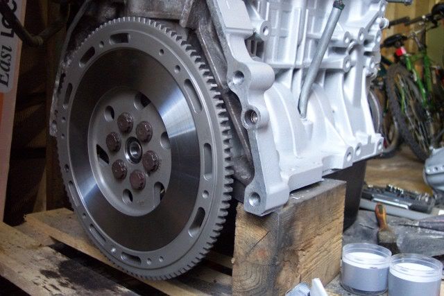

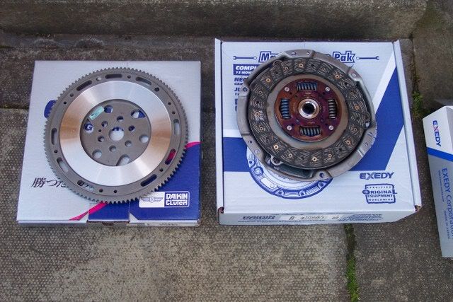

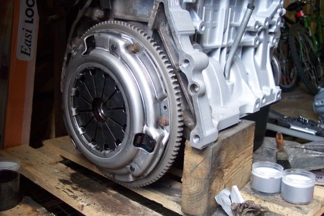

Bought a new Exedy clutch and flywheel so put that on

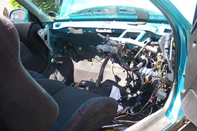

Took the dash out yesterday so i can put in the new OBD1 loom

Where you get clutch and fly from? :jerkbow:
By Graham
#59971 America somewhere :?
Was a group buy thing on the dc2 forum, think it was a company called Gripforce they came from

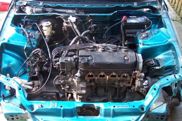

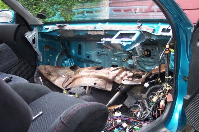

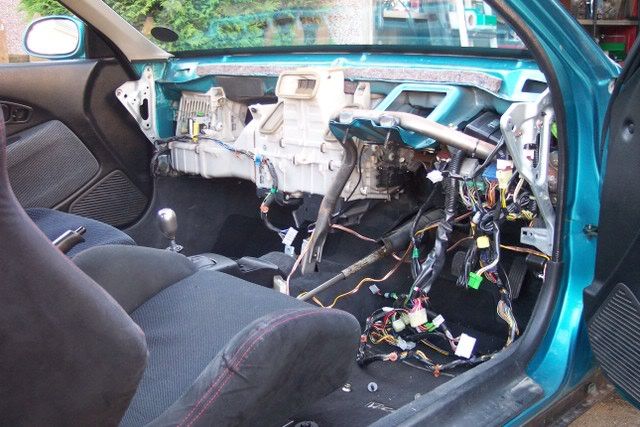

#60470 Swapped in the new OBD1 interior loom the other day, had to get right at the firewall meaning all the pedals and heater matrix etc had to go! Took a while but wasn't as difficult as i thought it would be
Put the new loom in along with the new p28 ecu and it actually works! Need to add in some more wires to the loom for various things and remove parts of it too so nowhere near finished yet

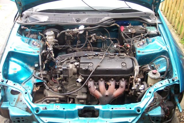

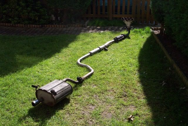

Also got the exhaust off eventually, its a mess - couldn't separate the sections so just dropped it off in one go
Just got to get the bitchpin out the gear linkage and it'll be bye bye crappy engine :lol:

#60476 nice clutch and fly :thumb:
#60478 Changing looms looks so damn confusing, wires everywhere. When I get a knot in a string, I cut it. Reason you'll never catch me doing shit like this.
Hats off to you sir. :whip:

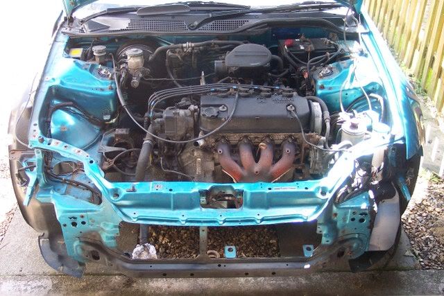

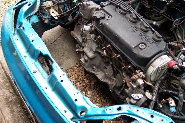

#61126 Did some more work today, took off the gear linkages and the 3 lower engine mounts - they need replaced though :o
Just need to borrow my friends engine crane now and get that sucker out :lol:

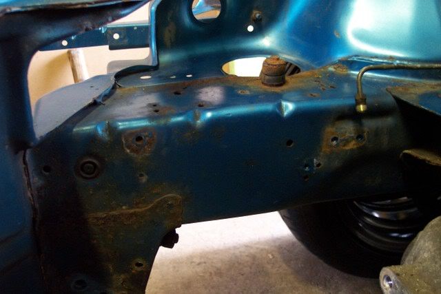

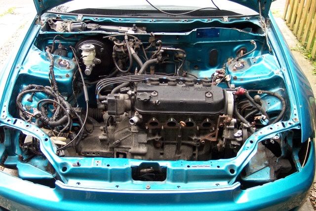

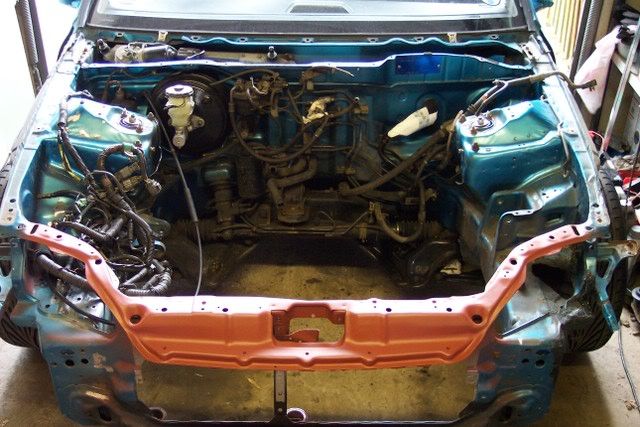

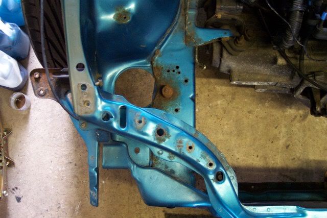

Might aswell update this again!! Been working away quite alot recently, the engine bay was a complete mess :thumbdown:
:x

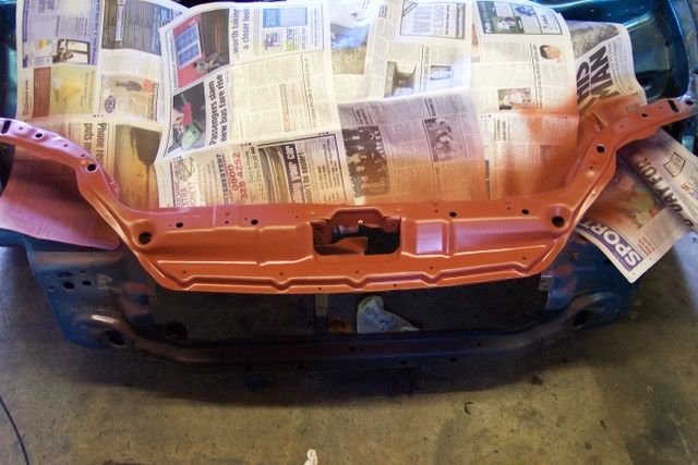

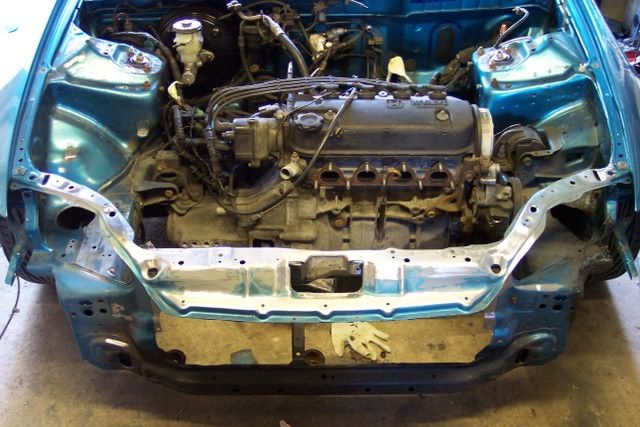

Started working on the slam panel a couple weeks ago, ground every bit of rust off it and primed it with red oxide primer, hopefully that will keep it rust-free for a while!!

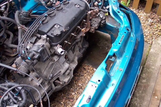

Then last week or 2 weeks ago, cant remember, i got the engine out at last - just dropped it on the floor and pulled it out under the car :P
Since then been working loads grinding away every bit of rust - there was so much, getting there though so will post more photos once its all in primer :thumb:

#63504 Very nice project keep up the good work
And dropping the engine through the bottom was something I was going to suggest when reading but heck you beat me to the punch.
