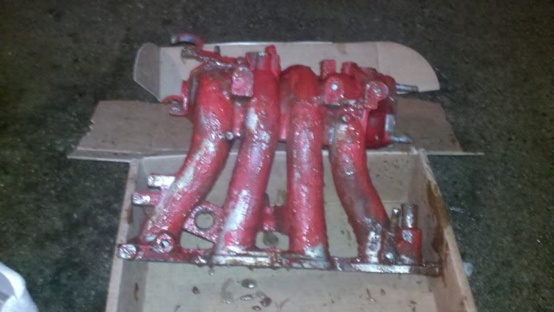

i don't have a finished product yet, started getting cold, and it was kind of raining... will have a final product up tomorrow. my intake gasket was ripped too, so replacing that as well.

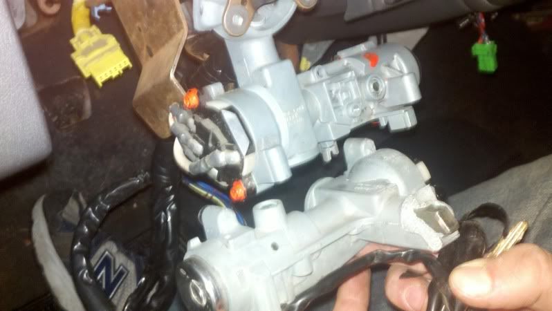

installed replacement, rented a freakin wheel remover and lock remover to find out my steering wheel wasn't even on tight....

when i took the intake off the intake gasket was broke in half. (was going to replace it with this, but didn't pan out right. still have to do it...) i noticed the shape of the ports on the head don't match the ports on the manifold. is this normal? or do i have the wrong intake on my car. if you port matched the head to the manifold i'd imagine you'd get a good improvement?! cause that's a lot of material you could remove and probly gain some better numbers.

what motor is in your car, D15b7? That is definitely the wrong intake manifold... maybe from a cx or vx?
I wouldn't even bother port matching... the whole intake will still have smaller runners, not optimized for your motor.
good news is you can get a D15b7 intake manifold for cheap. I think I even have one in my basement, the same one in this thread: http://civic-eg.com/viewtopic.php?t=3340

i've got a d15b8. i can't remember the stamping on it... i saw it when i was stripping the paint off...
i wasn't exactly planning on port matching it lol. just the thought of them wasting such space killed me! i've noticed my car has been kind of jumbled together...blue interior with a grey dash when it came with black. you know...small things that make you scratch your chin.
*edit* just checked my IM number. it's a P10?
