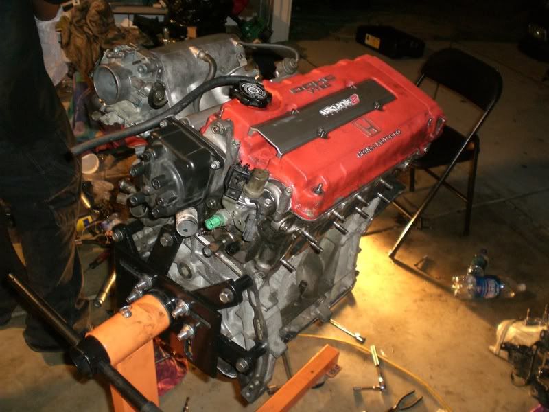

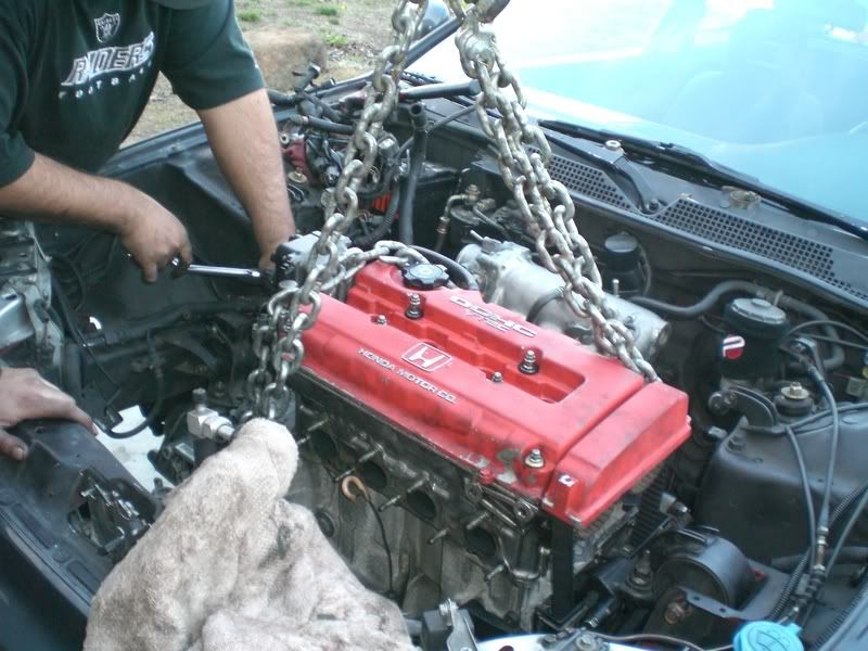

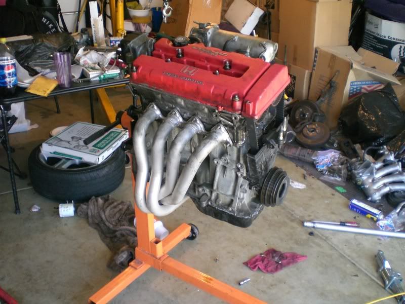

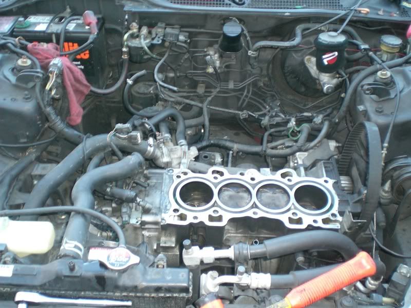

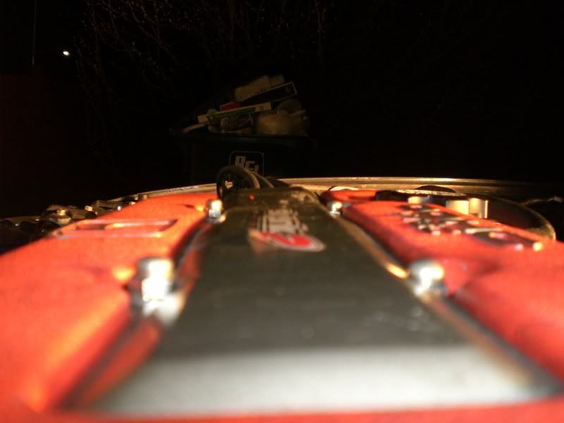

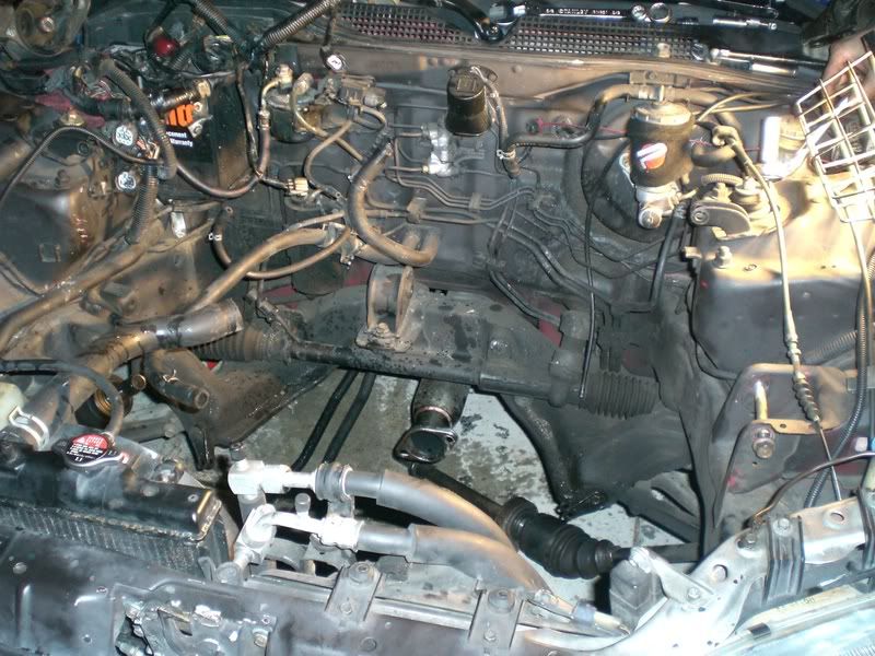

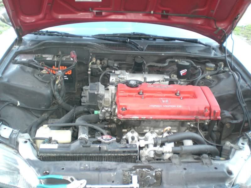

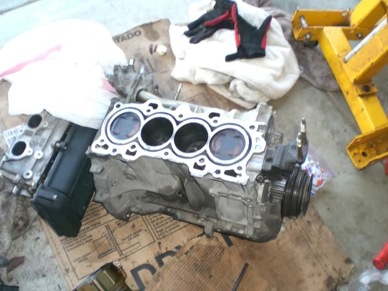

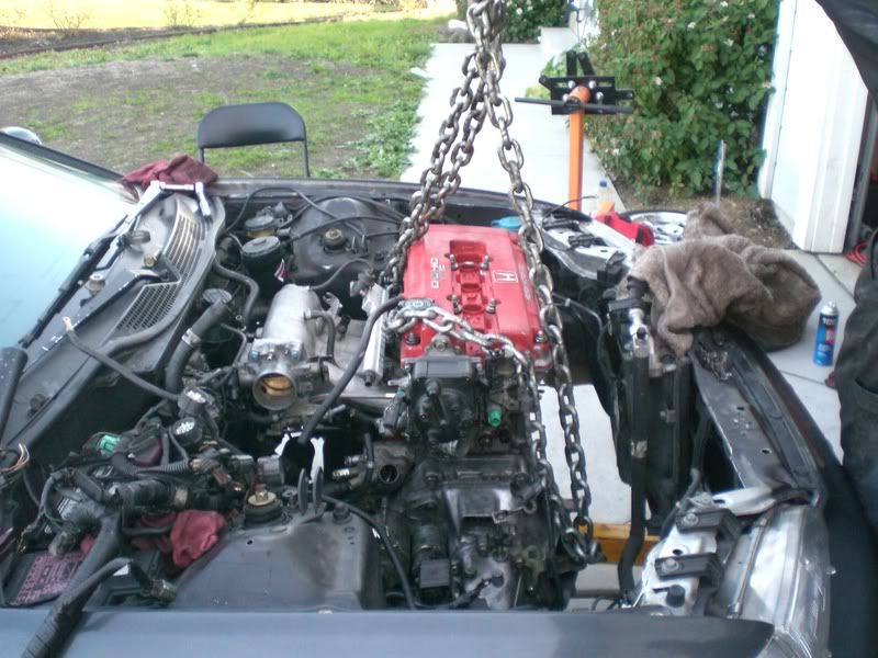

#42983 Alrite guy's so as some of you might know i just did a B20vtec swap this past weekend, so here are some pic's of how she was put together. Will be taking her to Redzone in fremont tommarow to get tuned :)
My b16
JDM B20B Block
Took the head off now time to take the B16 block out
My teammates helpin out
No more B16
B20 Block with Golden Eagle headstuds
B20vtec all put together
The header Fits :)

SKunk2 sticker FTW
