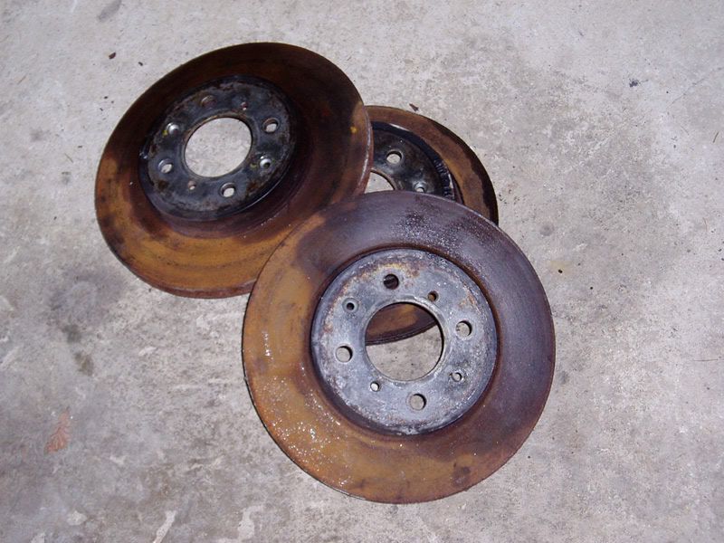

Old discs off, retaining screws came out with some persuasion (a large hammer and an impact driver)

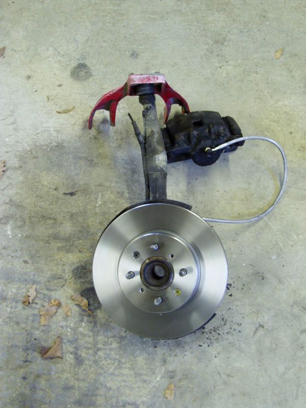

Shiny new front discs, the other front one is also on, as is one of the rear discs however...

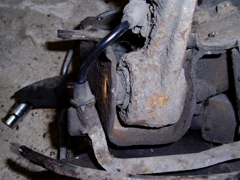

Sheared bolt heads... fail. So I've got to pull the entire hub off and the ducting to grind the nut off and then try and punch the rest of the bolt through.

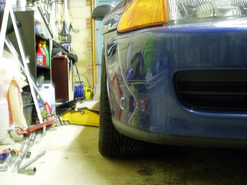

Got the front finished today (sort of)
No stainless lines up front though
Bit of an issue with the old ones not wanting to come off, so gonna run the originals for now. When the rears are attacked tomorrow where I have to change the lines, may find a solution to getting the front ones off.
Also...
Not too much camber
Also...
Not too much camber

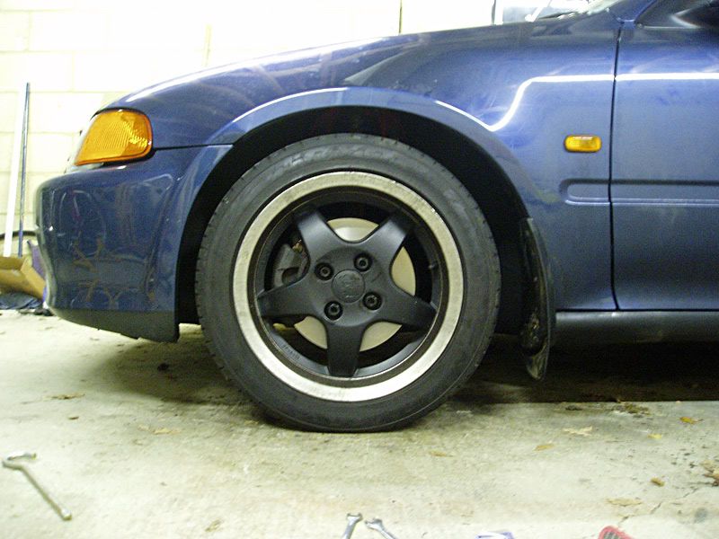

Raised the front up a notch as you can see above and the little bit of bump steer I had has gone completely. Bit strange as I was sure the steering arm was still slightly inclined down to the hub but apparently not. Drives like a dream at the moment, and the front end feels better in general, possibly because of the more normal stroke on the shocks. Or maybe I'm imagining it
