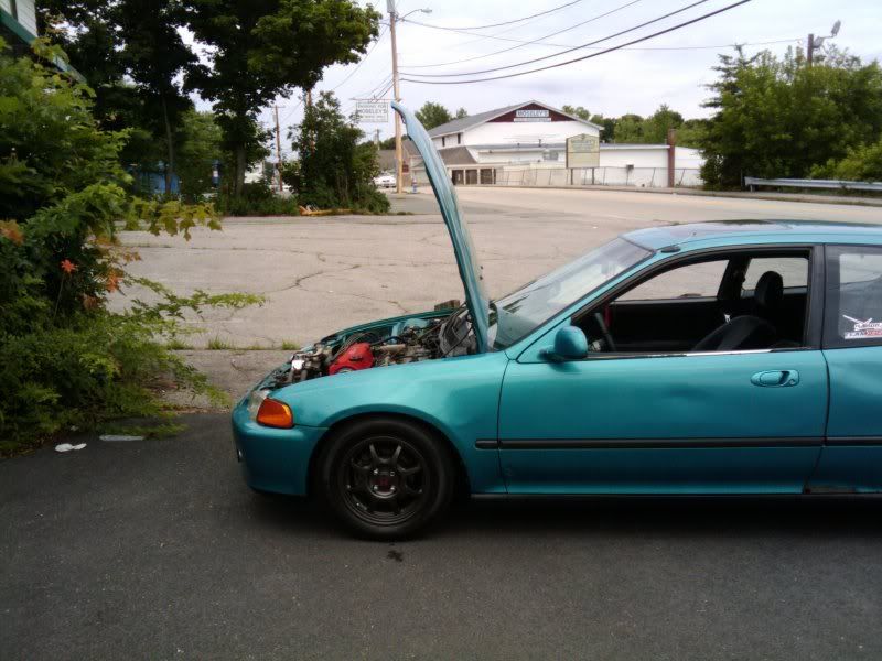

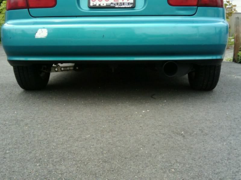

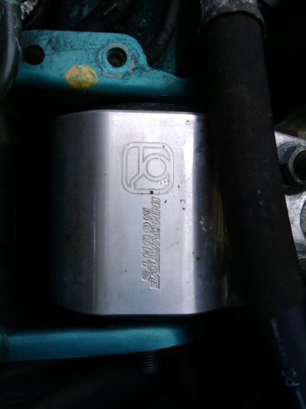

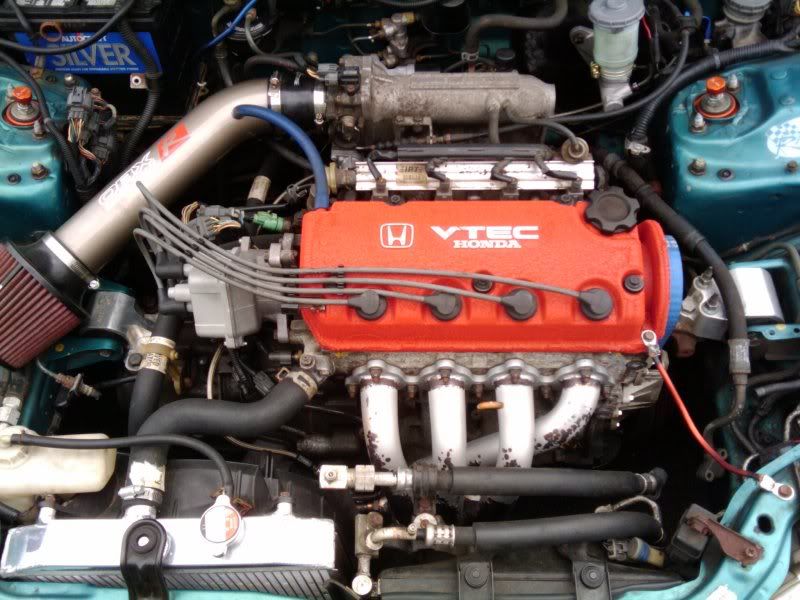

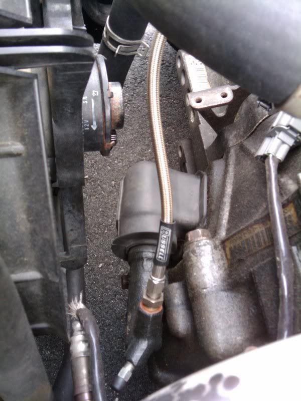

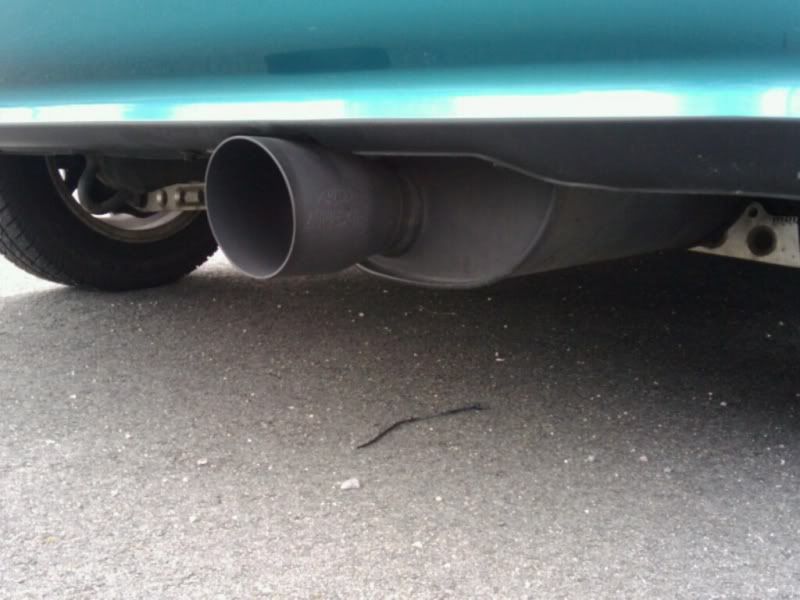

#200405 Got some pics today. since i was out in the day light. lol.. More to come.
Russell Direct line. actory hard line delete.
Innovative 75a Mounts. good for 500hp.

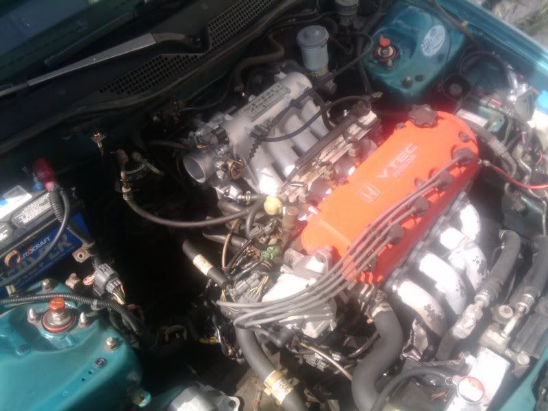

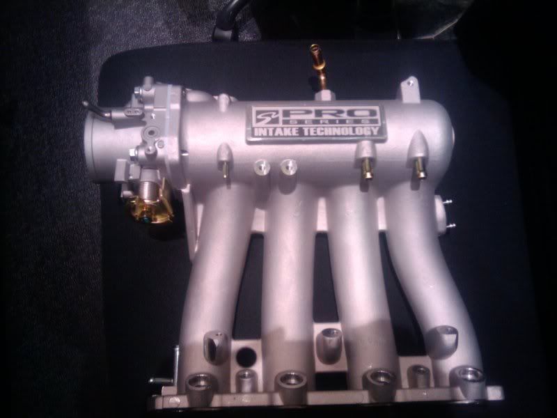

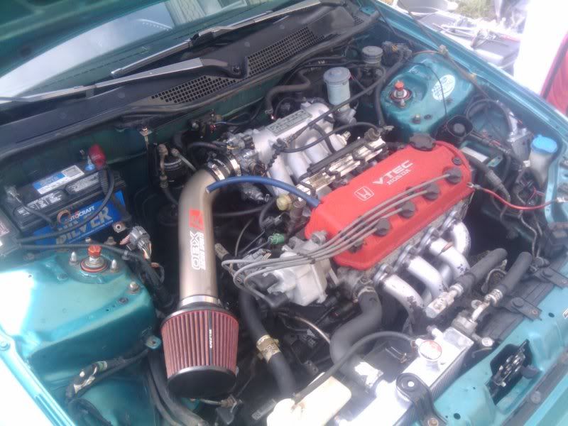

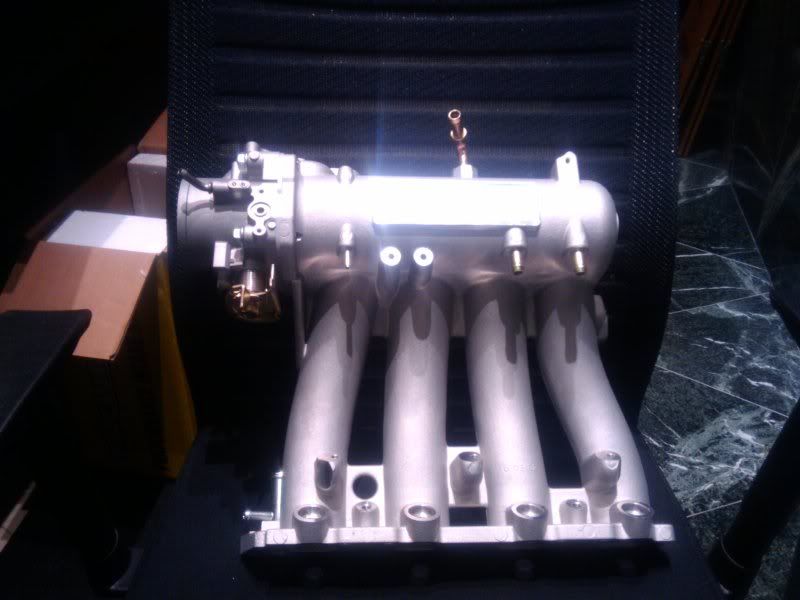

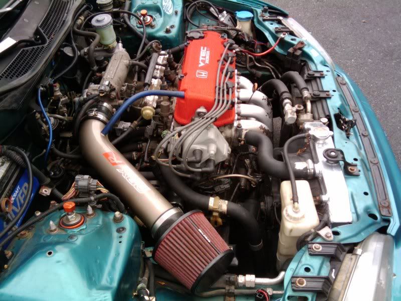

#219015 Update 10/18/2010

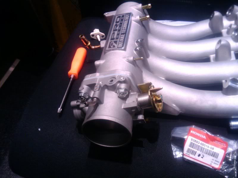

Paired with the Omni Power 68mm TB
The Before look..
And this is the stock z6 manifld on the left and the Skunk2 on the right with factory TB

#219207
Mcswens wrote:looks great! :thumb:
how well did that skunk2 manifold bolt up? i need to get a better one for mine.
It bolted up perfect. the only thing it sits closer to the fire wall. and IAT sensor is a lil tight.
The coolant port is really close to the #4 runner so getting the clamp around it is a beeoch. u gotta get the screw type ones and wiggle it on there.. other thn that it's good and simple to bolt up..

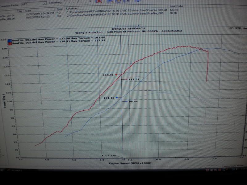

#219533 Sooooooooo i Got the Single jingle z6 tuned today. and believe me i was impressed!!! Will post up vids and Dyno sheet up in a lil bit. :thumb: :woot:
Has anyone ever dyno tuned a Mini me? what are the number that you got on that. ..

#219537 128 to the Wheel on a z6 with just bolt ons. Nice. Very Nice. :thumb:
By Eg6H2D
#219538 Yeap that's LS power right there.. lol. :woot:
It was leaning out towards the end a bit top end but not enough to hurt it.. . Fuel pump too old. Lol Walbro 255 on the way..
and that wavvy line is my 3rd gear.. Chrono it's time for a rebuild of the tranny. lol..
