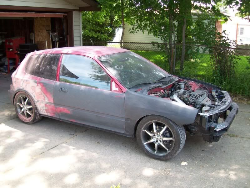

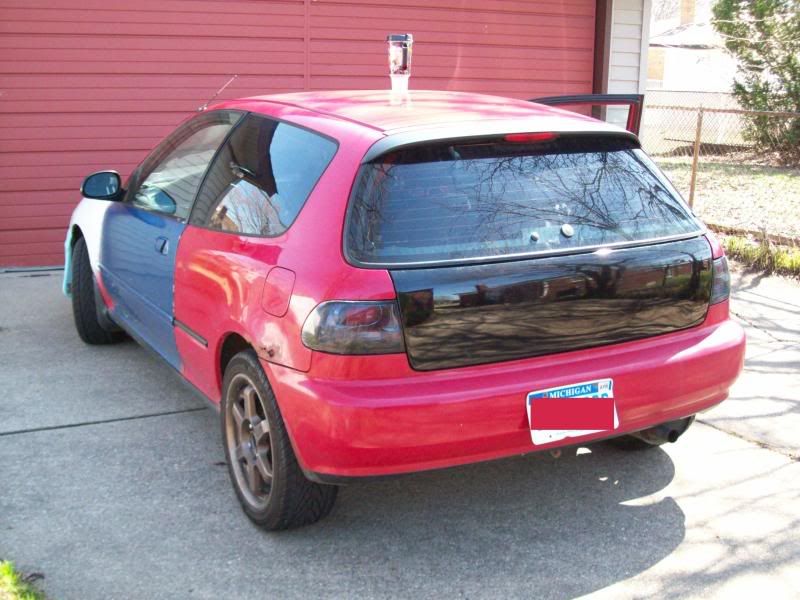

thanks for all the kind words, but im afraid im going to disappoint you here. it will be 2 tone one day but what you saw was a solution from necessity... i knew when i was spraying the primer, that i didn’t have enough to do the roof, so i just did the quick brake...
This weekend was all about getting it one color..... here is the blow by blow.
here is how she sat after firday, all the trim peeled, messed up windshield and all

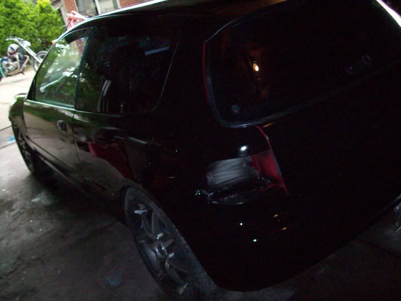

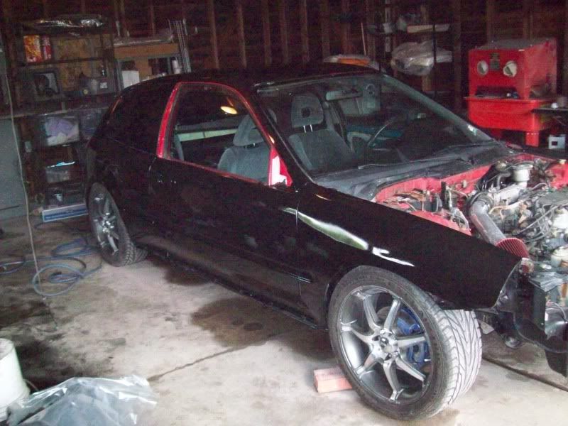

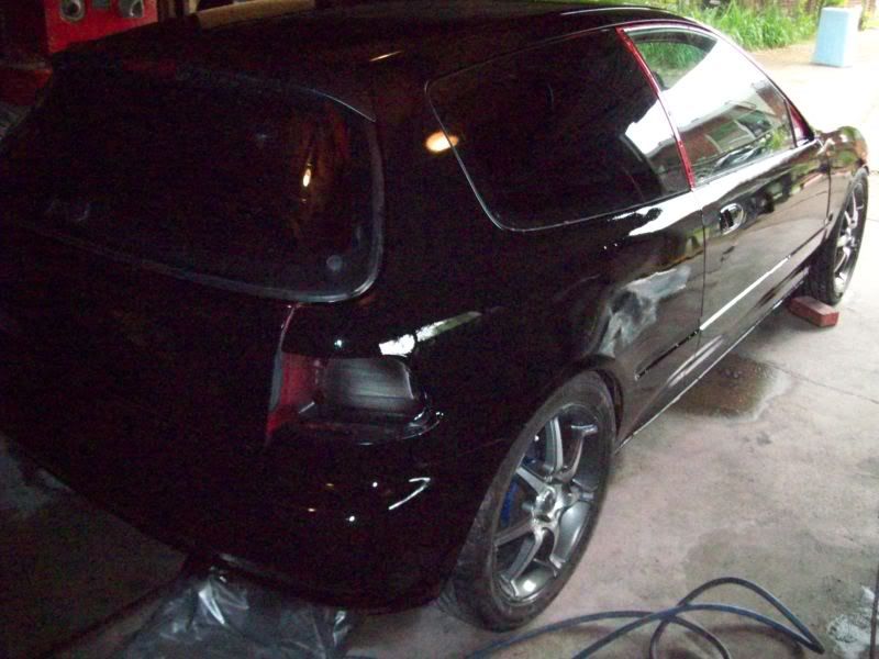

I totally f-ed up the paint job on saturday, runs and fish eyes like crazy... ah well, what did i really expect for $30 worth of enamel paint and thinner (god i hate single stage enamel and bad lighting!)...
pics from the fubar
today (sunday) i sanded down the worst areas, re-shot them, disassembled the headlights, cleaned them, painted the 'eye' rings flat black, reassembled the headlights, than put the car back together.
paint job is still only a 6 out of 10 but put back together it looks good

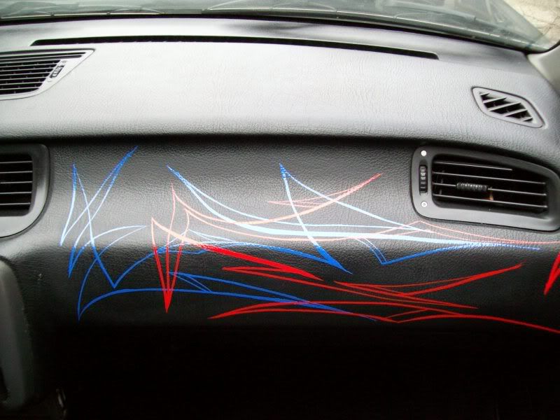

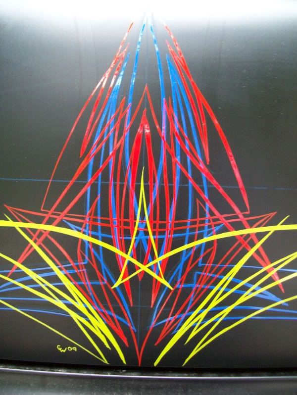

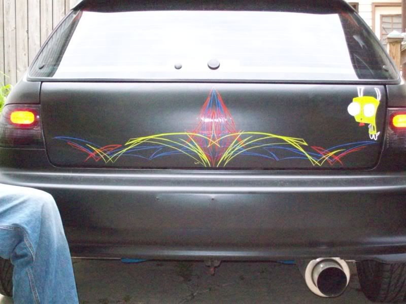

my friend chad went off on the car, i digg the results! i cant wait to see what he has planned for the sides, hood, front and possibly roof!
hood is going to look super sick (carbonfiber with pin-stripes on top)

#122836 im not fan of the pinstripes on any car but if you like it then thats all that matters :thumb:

yeah, the all back was getting on my nerves and my friend has mad skills but never gets any thing big to work on (usually just road signs and beer fridges) so i figgured id throw him some pratice and really make the car look like a rat rod!
it kinda worked, about 3 minutes in he said "ive never worked vertical, this is like a whole new ball game"

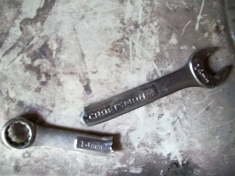

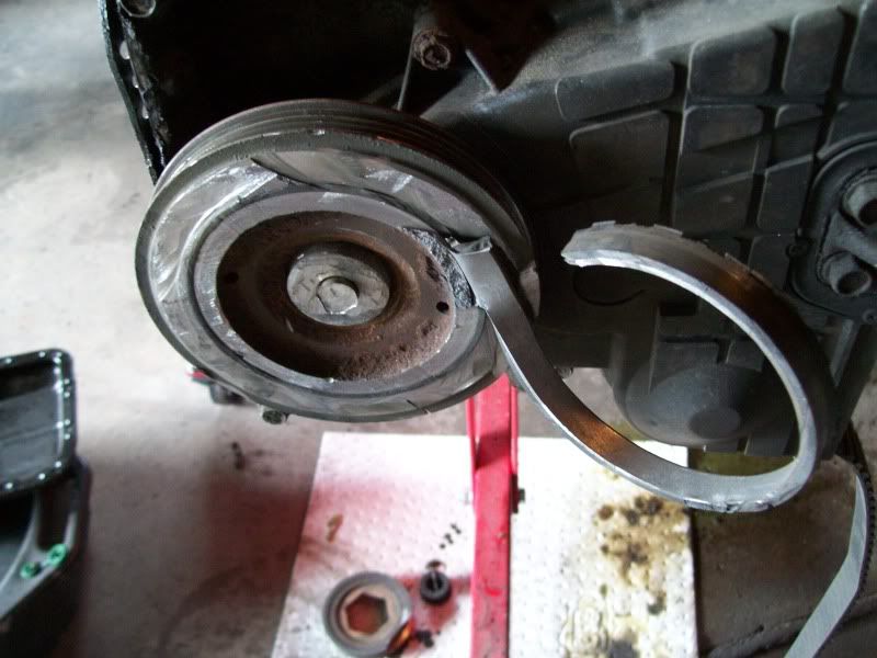

went smooth other than the underdrive pully nut... bent one 13 mm wrench into a u shape, and snapped this 14mm clean in half...
didnt even want to screw with it.... so seeing how im not going to use the crank and not using the pully, i took a few cut-off wheels, a sawzall and a grinding stone and cut it all away.
oddly enough once the head was cut away the remaining stud was finger tight and could be turned out with a pair of pliers....

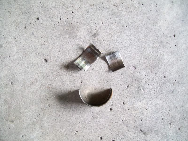

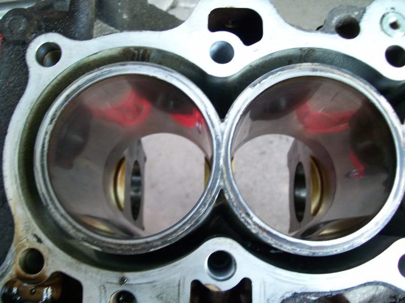

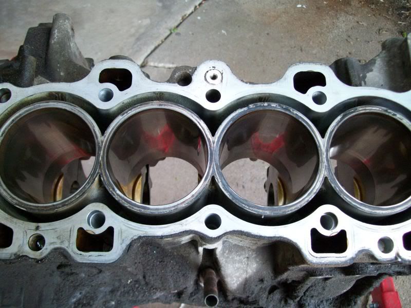

no wonder my friend had a rod knock on this engine ,
3 spun rod bearings, and the 4th one was split in half!

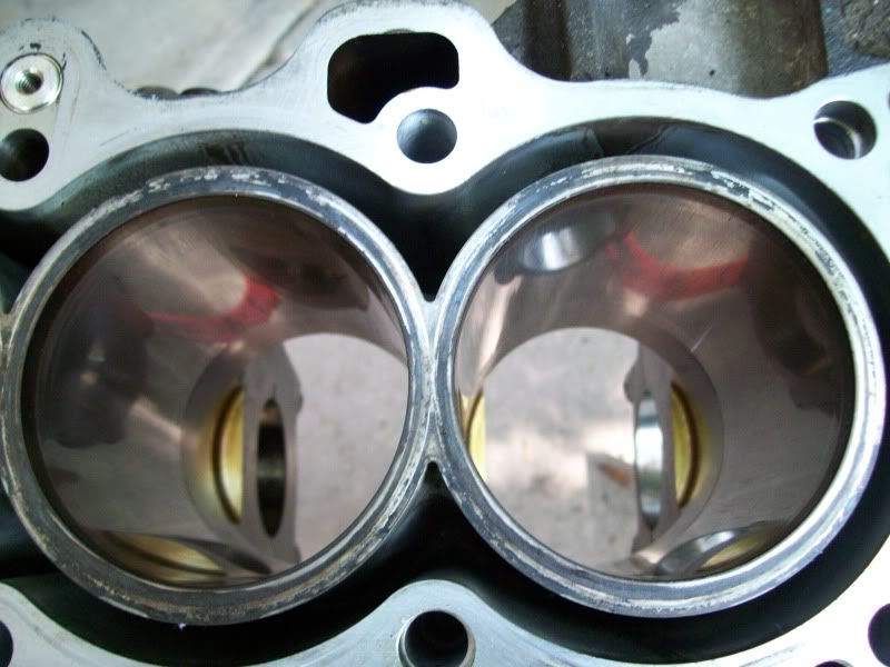

The main bearings looked just fine. the crank actually didnt hold up too badly. the rod jurnals could prolly use some polishing, but no deep gouging.
cylinders look brand new (minus hone marks)
no noticable crown ridge, little bit of burnt oil settled at the bottom, but other than that they look good. only the dial bore indicator will be the final word on that.
looks like we got a keeper
