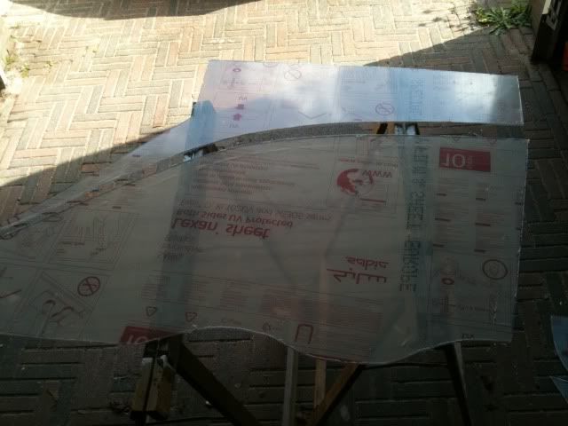

#196739 made a mold for my windows:
Polycarbonate 4mm plate
Testing:

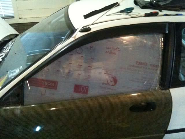

#196971 Today I got some spare time because of getting my new daily.
Just to point out to you all this isn't a walk in the park like you would see swapping OEM doors.

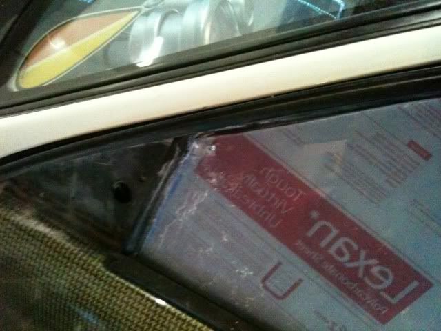

OEM window traced and cut out of lexan. OEM DOES NOT FIT AT ALL. On both sides I needed to cut 2cm extra off.

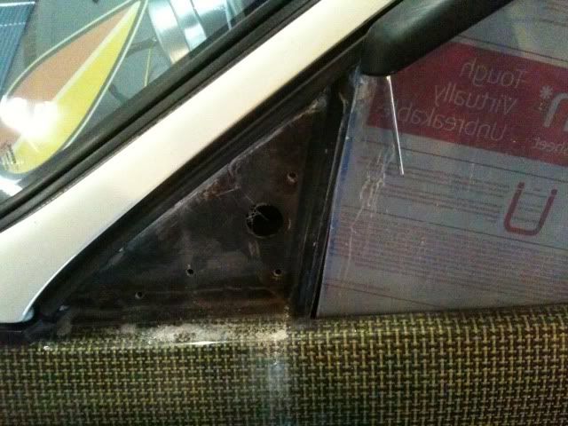

A small part of the window does not fit right. This is my solusion.
(there is some loose foil hanging no problems)

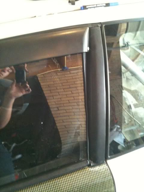

This is the front. There is no gap for the OEM moulding in the front. I need some solution here....
2 bolts in place underneath the visor. There is no window slider zo I need some solution for the underside aswell

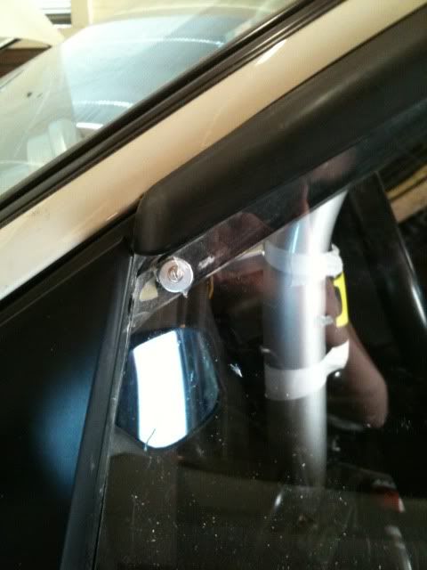

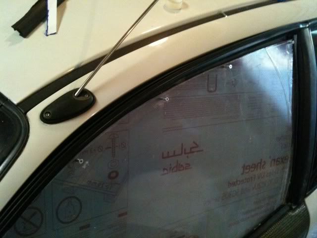

#197529 It's weeeekeeeenndndddd so I worked on the F***ng window again
Drilling holes
Testing because the first fit was an 0,5inch off...
OEM stuff cut up and installed upside down

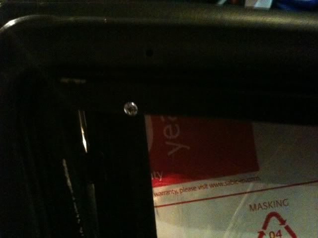

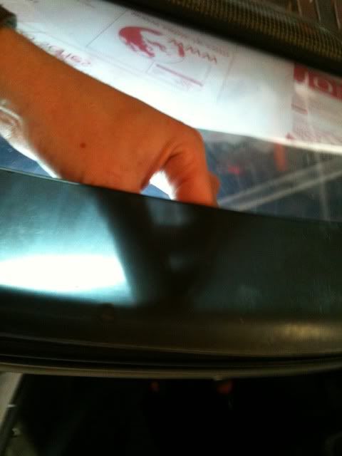

Because I wanted to keep the OEM look including my visors I need to drill a hole to make a bolt fit

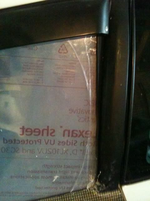

Final testing. Underside is stuck between the outer rubber and the inner dooruphosteryrubber. Topside will be bolted and glued. Because of the visor no one will see. Front and the back side a make a really narrow fit so it will not move

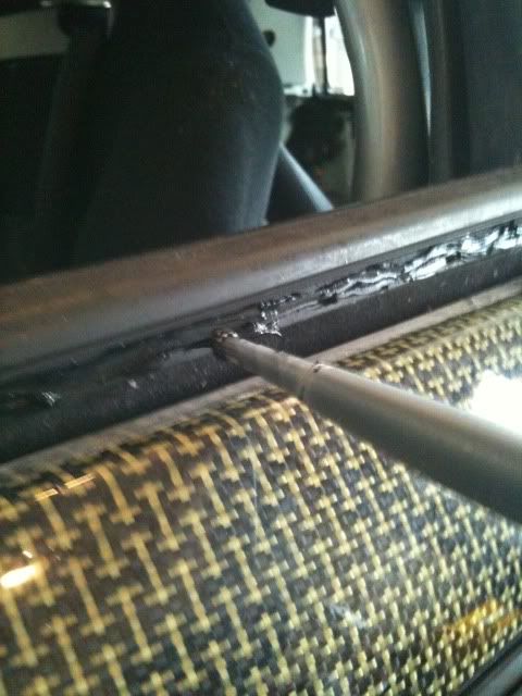

Glue:
Blind finger workout:

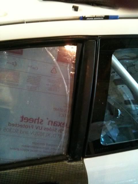

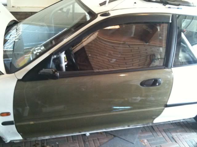

Left side DONE!!!
2 close-ups

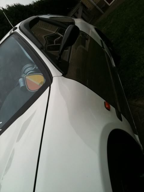

Drove her out to see some sun. My goal was to make it look like OEM.
What do you think??

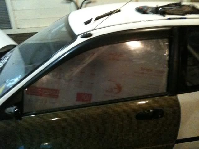

#200105 Been a while:
Just some minor things to do
made a testrun to see if it holds up
By chrisscott
#200146 im looking to put plastic windows in mine, are you keeping them a solid window or are you going to put window slider in.
By whitedxi
#200164 solids. 200kmh no problem
