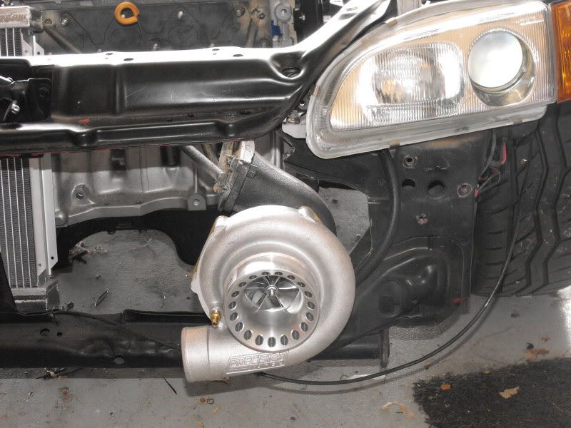

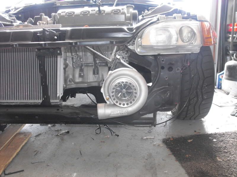

By flyinryan122
#209381 Here you guys go, AFI Turbo, forward facing turbo mani. The one and only they've built so far.
These are a few pics, intercooler core is on it's way, then i just have to build end tanks and purchase hondata s300 and we're golden :)
#209392 Man Thats Bad ASS!!! :thumb:
By flyinryan122
#209413 Hell yeah. This has been a 3 1/2 year long build. But we're almost done fellars
By 93cxhb
#209439 just read thru this whole build... and i gotta say :jawdrop: im speechless. shit is insane.
