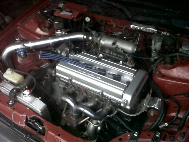

picked up this valve cover forever ago from member chilango.. a friend of mine has been telling me to let him take it to work and pick a color. so i finally let him and just told him do a nice silver.. I really like how it turned out!

#278777 Well fellas, her time has come..
Guess what they say is true about running their best before they go.. started her up yesterday, and all signs are pointing to a blown ringland.. got on it going down the street and smoke started pouring in the cabin. i popped the hood and smoke is billowing out the catch can and valve cover breather, nothing out the exhaust.
she did quite well.. i beat on her quite hard and made well over 100 passes down the 1320'. I should have got it re-tuned after changing the exhaust, but instead just lowered the boost controller so it would stay at the same psi. (the better flowing exhaust made it want to spool more)
THE PLAN!!
put the low mile JDM B18b in with a stronger clutch and tell Blundar to get it close to 300whp :twisted:. that should give me enough time to send the "blown" motor to the machine shop for forged pistons/rods, valve seals and dual springs in the head and rebuild my LS tranny. then we'll shoot for closer to 400whp
