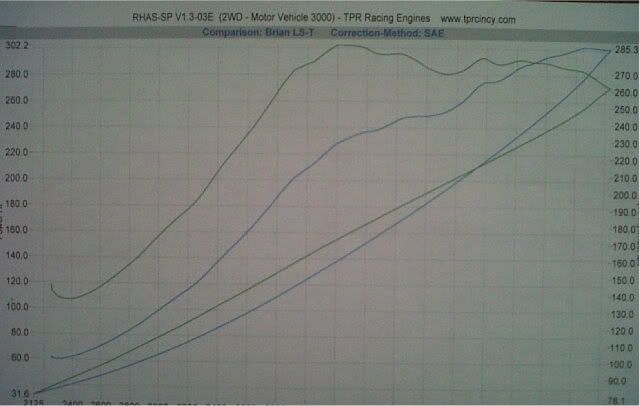

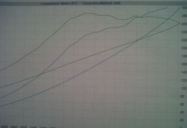

#283515 well.. i was pleasantly surprised today when i went up to the shop to get my dyno sheet print-outs.. I had forgotten to get them the day of, and apparently my numbers were way off..
here's the maxed injector 18psi pull making 286wtq / 310whp..
then on 15psi with better A/F ratios and some tweaking..
so it's actually currently making 302.2wtq / 285.3whp :twisted: :twisted: :twisted:

not sure about the ratios. getting a wideband is on the to-do list.. but honestly, my tuner is quite a bad ass and i've never been too worried about it. :lol: He's literally a co-creater of Crome, eCtune, etc..
i do know that on the 18psi pull, my 440's were at 100% duty and it leaned out a little. multiple pulls on 15psi were all in the low 90's% duty range..
#283595 Those dyno maps look good. all that nice nice torque.
Sucks you maxed out your injectors, need to get some bigger ones now. I'm thinking of starting out at 1000cc's so I dont have to ever get bigger ones.
Cant wait to see some 1/4 miles times out of this setup. it should be good.

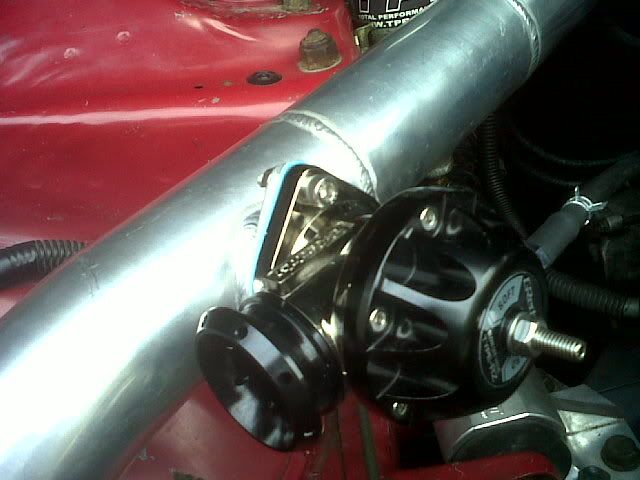

had a chance to get the hatch out yesterday and decided i couldn't stand the flutter/surge from my turbo that the HKS SQV 3 was causing at low throttle driving.. like just driving it through the gears would get a "cha cha cha" from the turbo between shifts. this is because my turbo spools so easily, but not enough when i let off to actuate the spring loaded valve..
got on craigslist, found a brand new in the box Greddy RZ for $100 :woot:
no more surge/flutter :D
