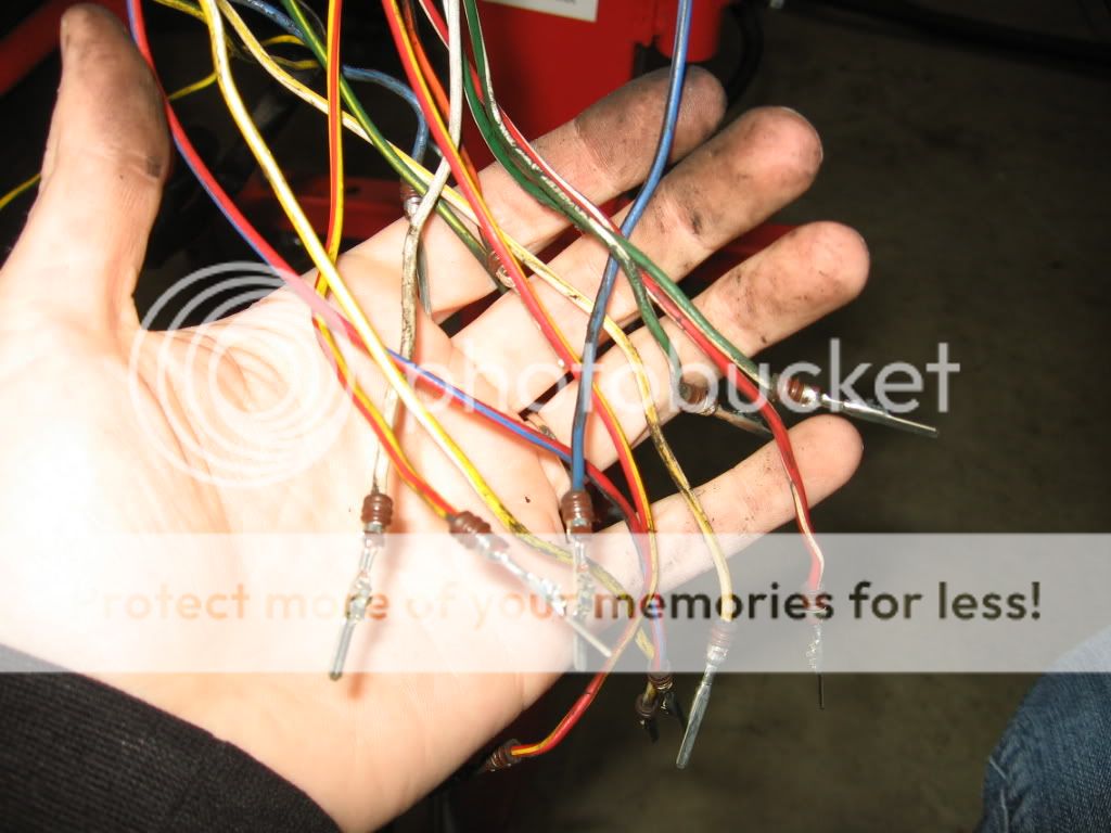

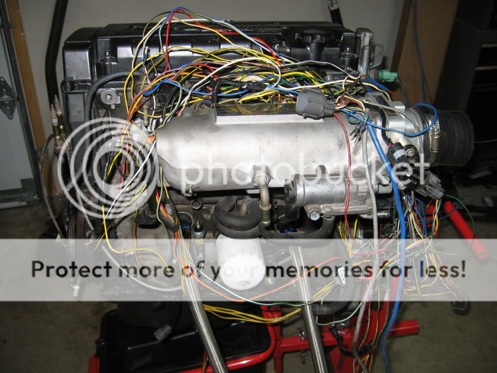

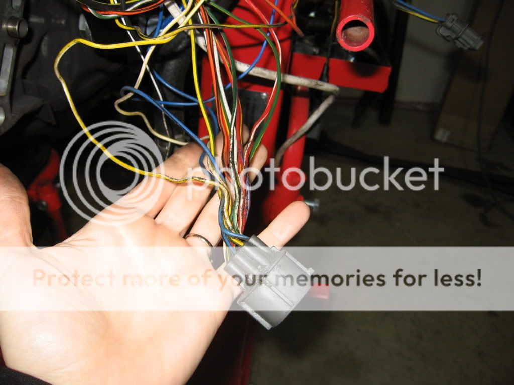

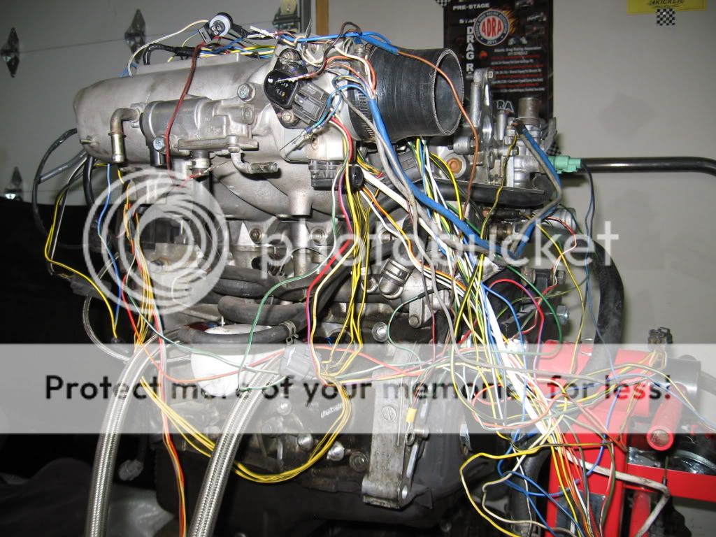

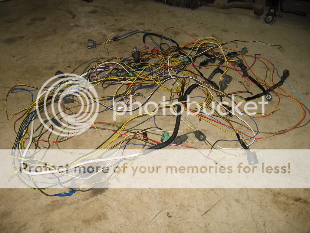

#285437 also started to build my tucked harness
I de pined most of the stock harness plugs.
mess of wires...
Next step is putting all new pins in my new plug. So I can have one big disconnect on my fire wall :)

#285443 everything is so nice! where'd you get that plug? needing one for my truck

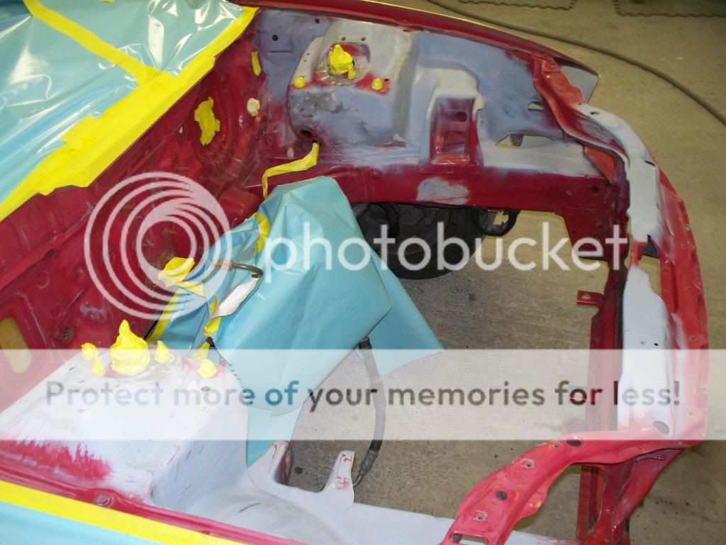

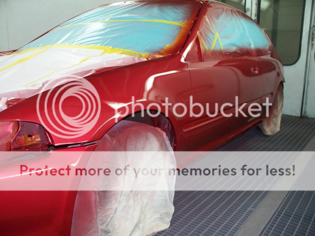

By dbrooks

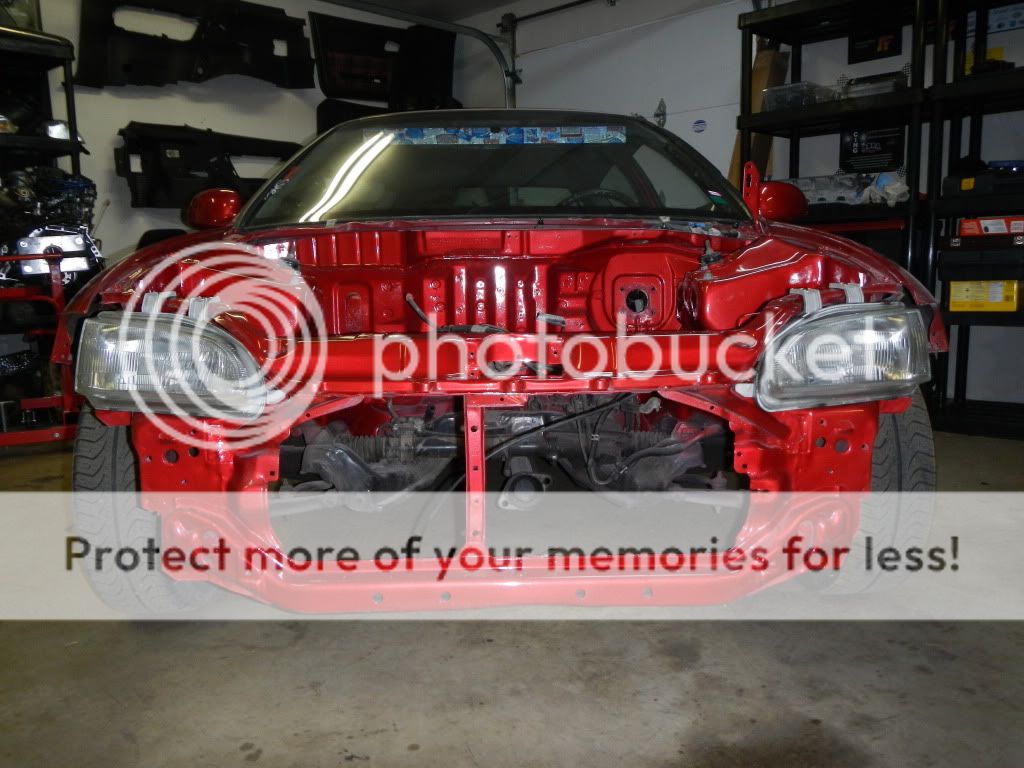

#285689 That paint looks so good :D

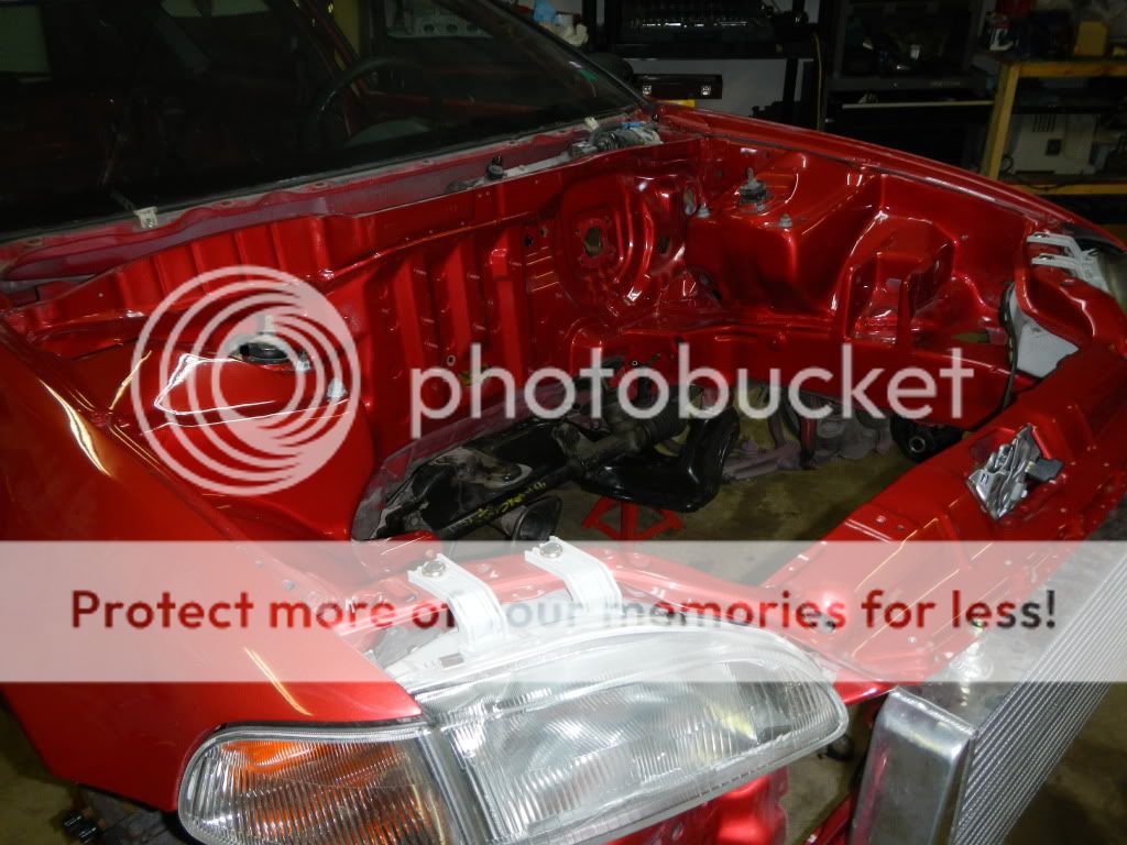

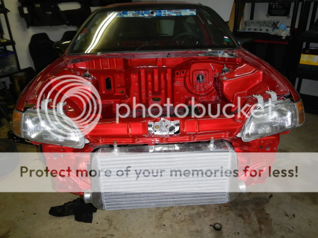

#288050 starting to put it all back together!
installed my manual rack! and for people that don't know, the manual rack will bolt up to the power subframe if you put the horseshoe shaped bushing that goes around the rack on the passenger's side, use 2 of them (wrap one around the other) sorta like a spacer.

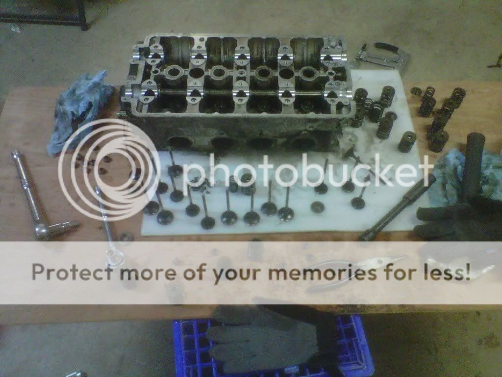

picked up a gsr head
also got my clutch and flywheel

#288084 are you going to be doing anything with the gsr head or just rebuilding it??
