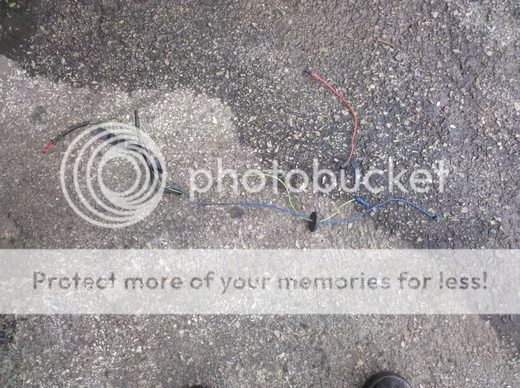

Wired up the Vtec that he ran two lines consisting of three different wires that didn't even make it to the ECU:
The ECU wasn't repinned-I think that's why the ECU plugs were all chewed up... Xenocron to the rescue!!
