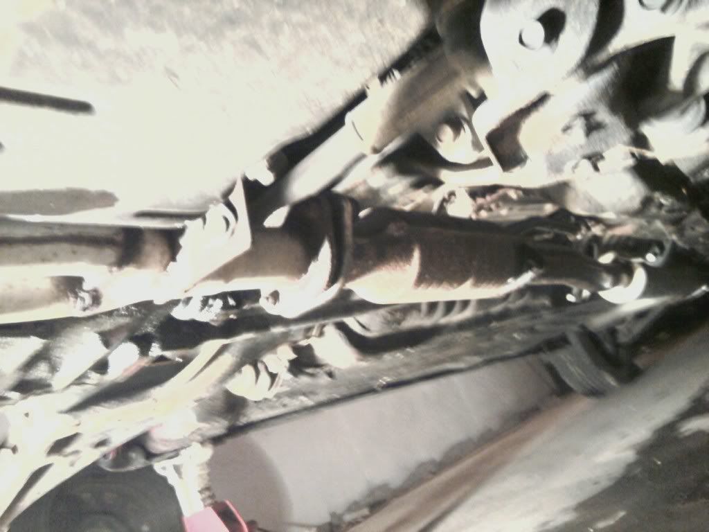

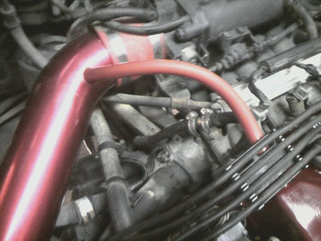

#254217 so today went to pull the coupe outta the garage so i could do a lil cleanin up found out that the metal line that hold coolant by my cai tube was squirting coolant like a mofo so fixed that and then once i pulled her back in the garage i put the front end on jackstands to do a more indepth check of the bottom of the motor,body,exhaust ,etc. and found out why my downpipe was leaking and why my exhaust rattles.. the dipshit p.o of my coupe decided a car doesnt need a flexpipe so its all solid. :x also found out that i definitally need the E.S shifter bucking kit and possibly rear trailing arm bushings. more updates tomorrow but heres a couple crappy phone pics of what i mean.
the coolant tube fixed.
the exhaust with no flexpipe and cat converter with no heatshield.
again my bad for the bad pics but it gets my point across

#254221 eg's dont come with flex pipes the exhaust hangers allow the exhaust to move enough. the rattling is coming from the stock piping for some reason honda thought it was a good idea to put a pipe inside of a pipe and the inside pipe probably rusted off the welds which then causes rattles my ej2 and brothers ed7 had the same problem. so the only way to get rid of the rattle is to get a new ehaust :thumbdown:

#254222 the rattling is under the body were it bends after the resonator bc the guy did something wrong with it i dont know what but it seems to short. and from everything after the cat looks fine just a tid bit of surface rust on the welds but from mani to cat is shittty.

#254223 also everthing from the cat back is aftermarket 2 1/4

#254269 your right, they dont have flex pipe. However they also shoudlnt have that big plate welded to the downpipe and then to the chasis. unless im seeing that wrong. It looks like thats whats going on in your pic. If so grind the plate off of there.
Gotta love previeous owners.

#254284 alright i mean i was thinking bout just puttin one on there for shits and giggles fo alil extra assurnce but ifthey dont even come with one then im set. yeah ill figure out that whole deal with that plate. also doing the tb,tensioner, an waterpump today hopefully the crank wont be a pita sicne i got a impact and a goo compressor.
