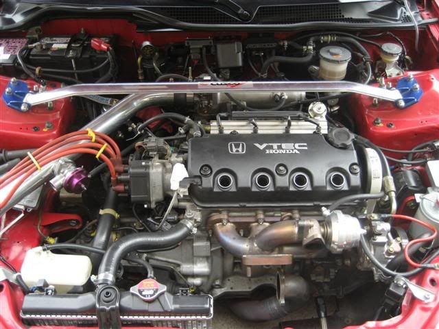

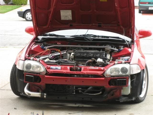

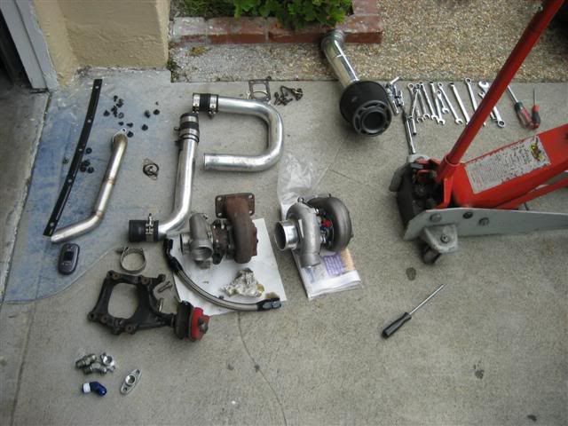

#44249 Finished installing the turbo today... it was rather long and tiring.. I didn't expect to run into many problems.
T3 Super60 OUT, GT2871R IN
in the process..
First one I ran into were the fittings I bought were not the proper angle. The 45 AN fittings would hit the block..something I did not anticipate since most GT kits gave you two 45s.. But luckily I had a 90 for the water port adapter so I used that and routed the coolant line all the way to the back from the PS side.
Now my front water port with a 45 to the front 45 looks hilarious as in the final pic..
still some minor stuff to take care of as coolant is leaking at the water port (guess not enough teflon for the top plug)
and the turbo needs a mesh and tuning.. :)
