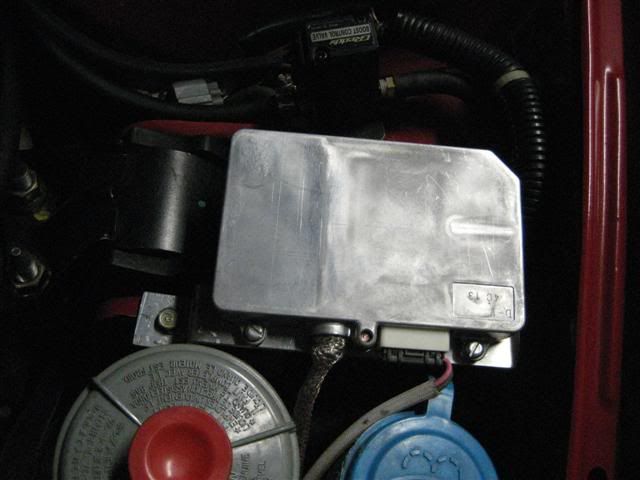

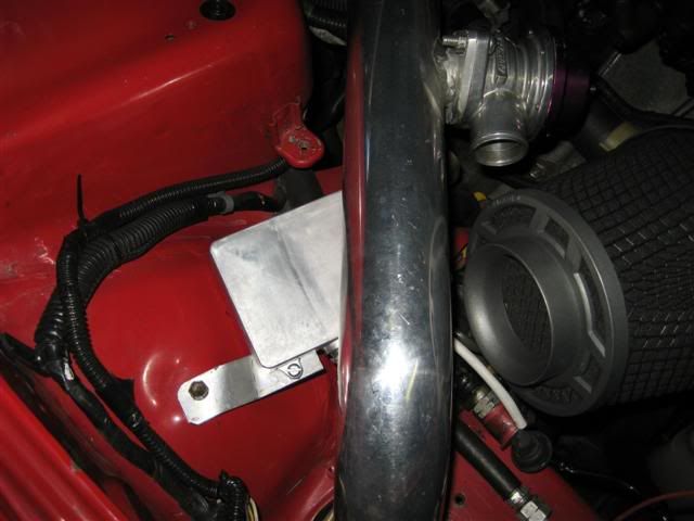

oh yea.. dude. where did you tuck your ballast? I'm curious where to put that too.. this weekend I'll be working on the hids on thanksgiving day.
#30512 I mounted one ballast on the frame rail where the factory airbox bolts onto, and the other i bolted ontop of one of the power steering lines, i will have to get a pic to further explain, cause i know it sounds confusing :lol:

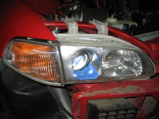

#31005 well i decided to see if i could fix the problem with the aiming..
so far so good. I cut a bigger hole in the back and the projector was able to tilt lower and aim lower. The problem is the projector now is sitting too low in the stock shroud so it somewhat reflects off the shroud. I cant get by that since I'm using a shroud not for this projector. So basically i will sand the shroud tomorrow and it should give less glare. Once I'm done with that, i will have to figure out how to seal all this crap and then wire up the badboys. :D
output pics will happen once everything is done :]
in the mean time here are some pics. Blue tape is where it is reflecting off, I tested it with the bluetape to see if it would reduce it and it was successful.

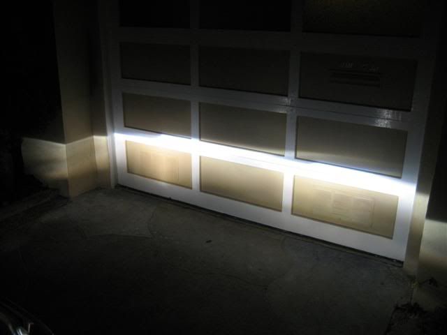

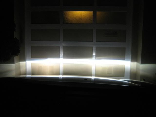

#31056 Just got the final touches finished. I still need to fix the horizontal aiming now. It is crooked but a tad.
Also high beams needs to be wired. Besides that, everything is in and functional :]
here are some pics of where the ballasts are mounted and output pics! :]
Headlights arent fully sealed yet for final touches.
and one of my LED clusters..its actually more white than in the pics..

Looks good Derbo, Those are the locations i mounted my ballasts as well :thumb: ... if you see some shrouds let me know i really want to redo my retrofit, but can't for the life of me find some shrouds :x
