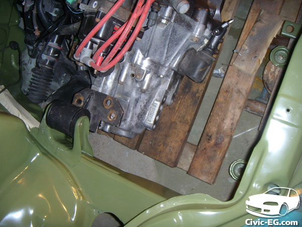

After you have double checked that nothing is still hooked to the motor, unbolt all 4 bolts on the rear motor mount (reach 3 from the bottom, the one closest to the motor can be reached from the top. After you remove the 4 bolts, wrestle with the mount so that it is pulled up away from the block. (I wrestled it for a while and couldn't get it all the way out.

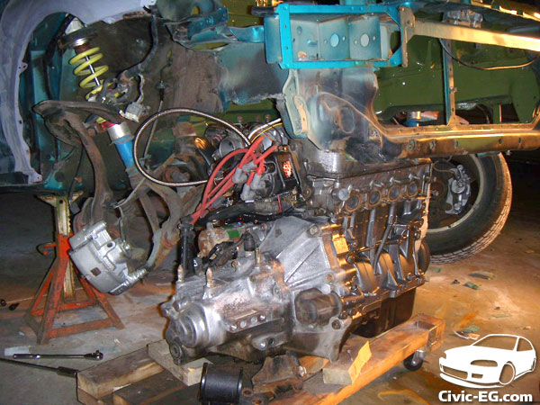

Measure the height of your motor and be sure your jack can lift your car high enough to slide the motor from under the side. You might need to add some wood blocks, but not too many or the car won't go low enough to set the engine down.

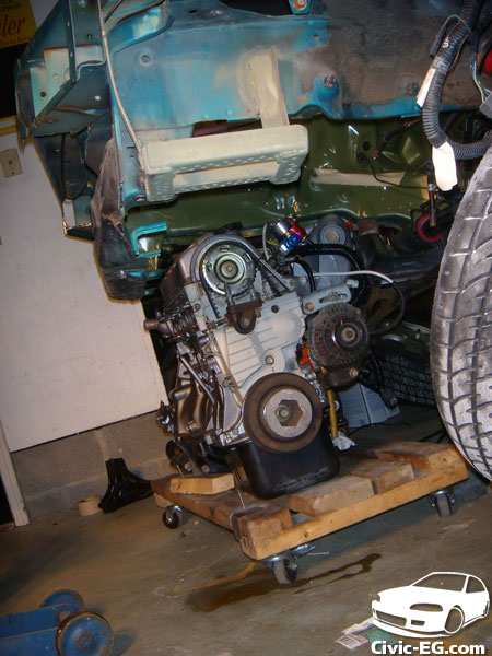

I made a little cart out of some scrap 2x4's and (4) $4 casters. It worked out perfect that the cart was high enough to roll over the end of the jack.

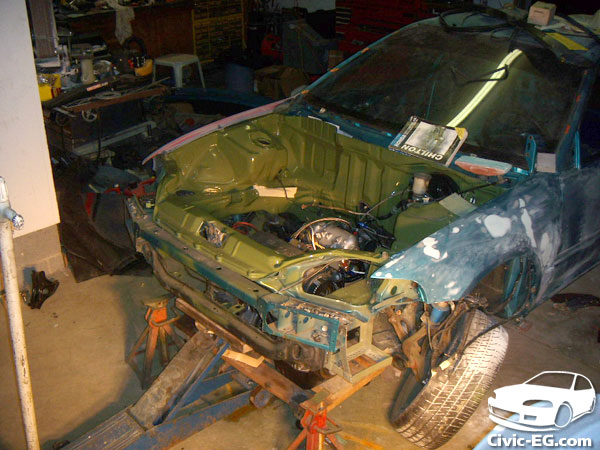

Now put the jack with 2x4's for additional height under the radiator support & lift a little, then pull out the jack stands.
With the cart under the motor, let the car all the way down slowly.

As you continue to lift the car you will need to slide the motor/cart forward since the intake manifold sticks out over the back of the motor.
The rear mount, you will have to wedge it up like this and watch as the motor drops that it does not get hung up on the throttle body.
Keep lifting and when it gets high enough put the jack stands back under.
Clear some room...
You can take the motor out either side. I didnt feel like looseing the rusty bolts holding the front tranny mount, so I went out the drivers side.
all done
