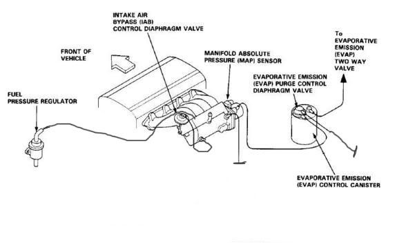

TNFBandit wrote:ok so this is how my vacuum is hooked up FPR just goes straight to the intake manifold, i dont have a IAB vacuum tank or an evap purge control solenoid valve
is this ok?
does anybody have the fuel pressure regulator part number...stock one?
thanks
I dont know the part number. Find which year and model honda your motor came in and then tell the auto parts place you need a fpr for that car. Good luck hopefully that fixes your problem.
Yeah your fpr should just hook strait to your intake. The purge control valve is not important.
Does the vacuum line just go strait into the back of the intake where your pcv should be? If so try pulling it off, the pcv has a breather so i dont think its actually supposed to create vacuum. My car has the canister line plugged and the intake one is still connected to the pcv. (the top of my pcv broke when swapping motor). If yours is connected then it could essentially create a vacuum leak.
