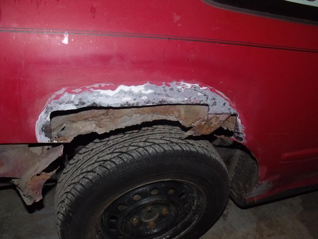

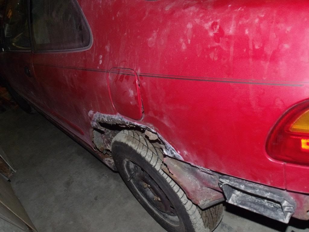

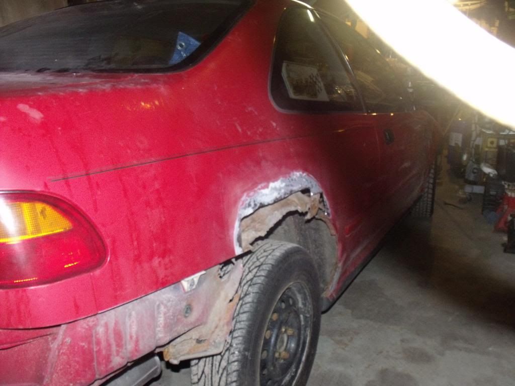

got some pics of the rear quarters cut out all the rust gonna get some metal and some corse filler.

Well the new quarters will already br the right shape all around which makes it much easier. Go to fixmyrust.com and check out the stuff they have. They have either full or partial quarters, looks like you can just get the partials.

hmm i dont see the partials anymore. You can contact them and see if they still have them. Otherwise id say its up to you on whether you want to buy the whole quarters and put them in for ease or possibly save some money and build them yourself.

id just mark and cut that rust out,dont even waste time cleaning it up.go two inches past and then prep for welding...

If you only buy the partials.You wont have enough metal for the *dog leg* Back from your doob/below the body trim.My advice to you is find an old beat up civic eg door and cut the bottom portion(below the body triim) out and thats a part of your quarter.You can also use the hatchback quarter but you have to modify it a wincy bit where the rear bumper mounts.
